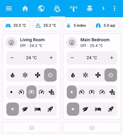

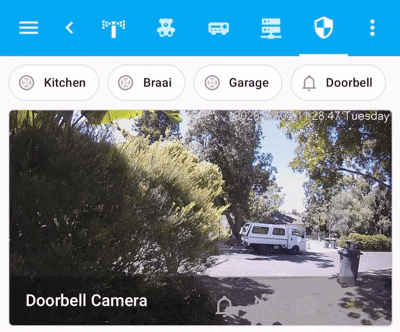

Circling back to this, I’ve added this to my themes with some small modifications.
Note that this is only confirmed to be working with badges at the top of a masonry view (i.e. not for section views).
  card-mod-view-yaml: |
    :first-child $:
      hui-view-badges $: |
        /* mobile-specific styles */
        @media (max-width: 768px) {
            .badges {
                overflow-x: auto;
                -webkit-overflow-scrolling: touch; /* Smooth scrolling */
                scrollbar-width: none; /* For Firefox */
                flex-wrap: nowrap !important;
                justify-content: unset !important;
            .badges > * {
                min-width: fit-content;
I’m using flex-wrap: nowrap !important; instead of flex-wrap: unset !important; to make the wanted behaviour explicit. I’ve also added the @media media query, since I only want this behaviour when the width is narrow (like on mobile phones), so that the default behaviour applies otherwise (I don’t have that many badges).
The scrollbar is also hidden in all cases. It just looks better to me.
I’ve also considered always keeping the row centered, but didn’t like the look. For anybody that prefers that, replace justify-content: unset !important; with justify-content: center !important;.
ScreenRecording_02-04-2025 11-28-24_1
ScreenRecording_02-04-2025 11-28-51_1
Lastly, if you’re using the default HA theme, you just need to create a custom theme with the following to only override this one bit of behaviour. If you have HACS themes or other third-party ones, you will need to manually edit those and remember to reapply the changes, should there be an update for a theme.
