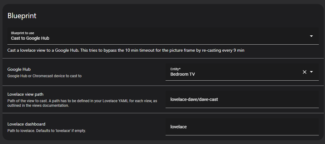

I tried setting this up yesterday to cast to an Android / Google TV. I get a message on the TV that the view cannot be found. I tried so many variations of view/path that I was going crazy.
Can someone please point me in the right direction? It would be great if the instructions were clearer…
I want to cast this dashboard / view:
xxxxxxui.nabu.casa/lovelace-dave/dave-cast
locally this is http://192.168.0.14:8123/lovelace-dave/dave-cast
So what do I put in here?
alias: Cast Security Dashboard to Bedroom TV
description: ""
use_blueprint:
  path: kind3r/cast-and-re-cast-a-lovelace-view-to-a-google-hub.yaml
  input:
    player: media_player.bedroom_tv
    view: lovelace-dave/dave-cast
The above wasn’t working, I get the HA logo screen on the TV with a message saying it can’t find the view.
The view setting maybe should just be ā€œdave-castā€ā€¦ read below and let me know what you think -

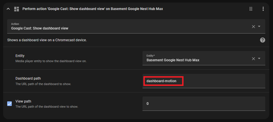

I had alot of trouble figuring out the path as it was not very obvious and I struggled with it too. First I went to the browser URL for the view I was using (###.###.###.### is the IP of my HA instance):
http://###.###.###.###:8123/dashboard-motion/0
With the above in mind, this action does the casting:
And here is the .YAML:
  entity_id: media_player.basement_google_nest_hub_max
  dashboard_path: dashboard-motion
  view_path: "0"
enabled: true
action: cast.show_lovelace_view
Note, if the device to be casted to is not on the same vlan (or subnet) as HA (for example if HA is on 192.168.0.X and the device to be casted to is not on 192.168.0.x but instead, 192.168.10.x) - casting will only work if mDNS reflection is turned on, utilizing the bonjour service id ā€œ_googlecast._tcp.localā€.
If they are on the same vlan then disregard the ā€œNote:ā€ above…
Hope that helps -

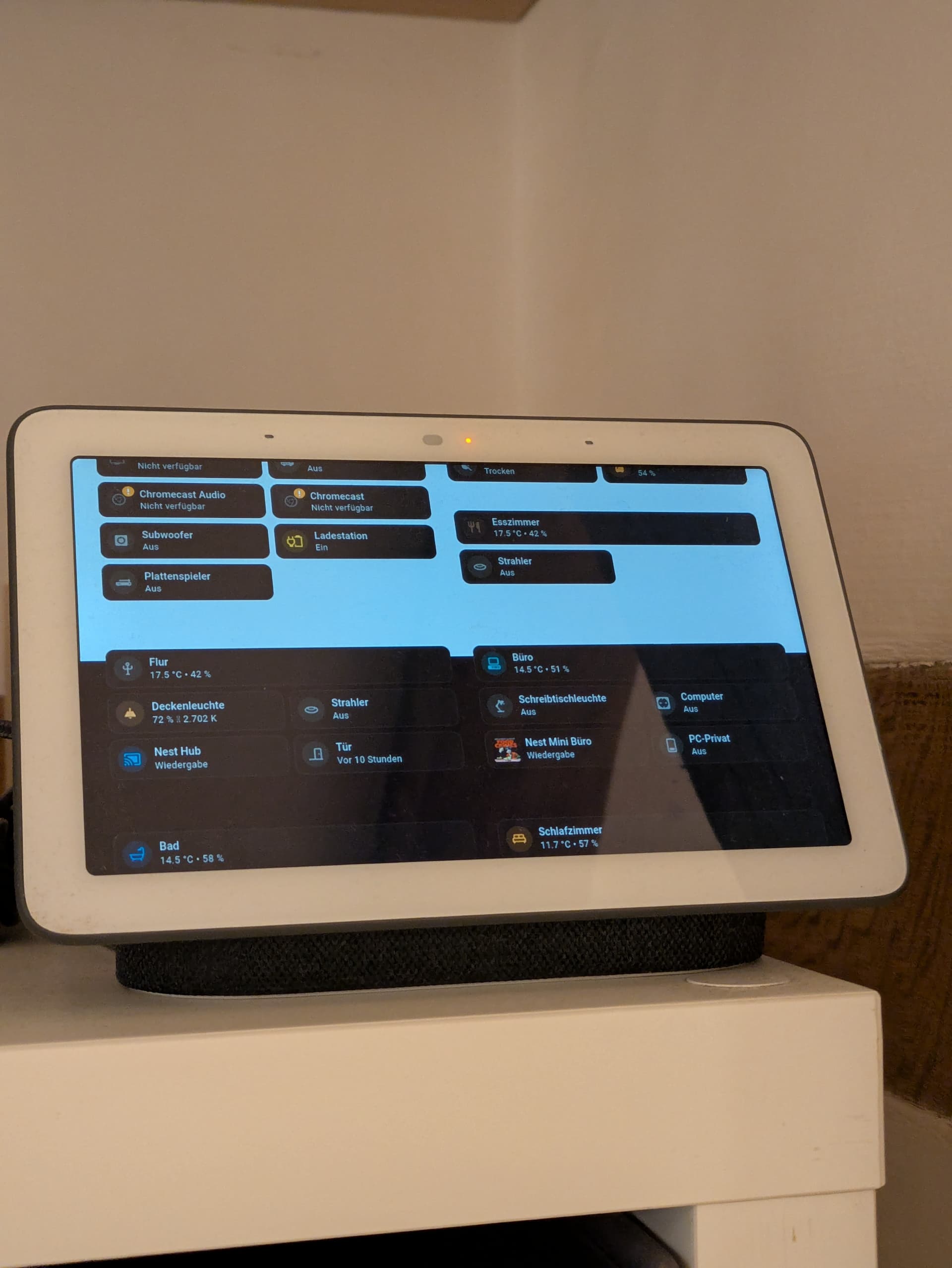

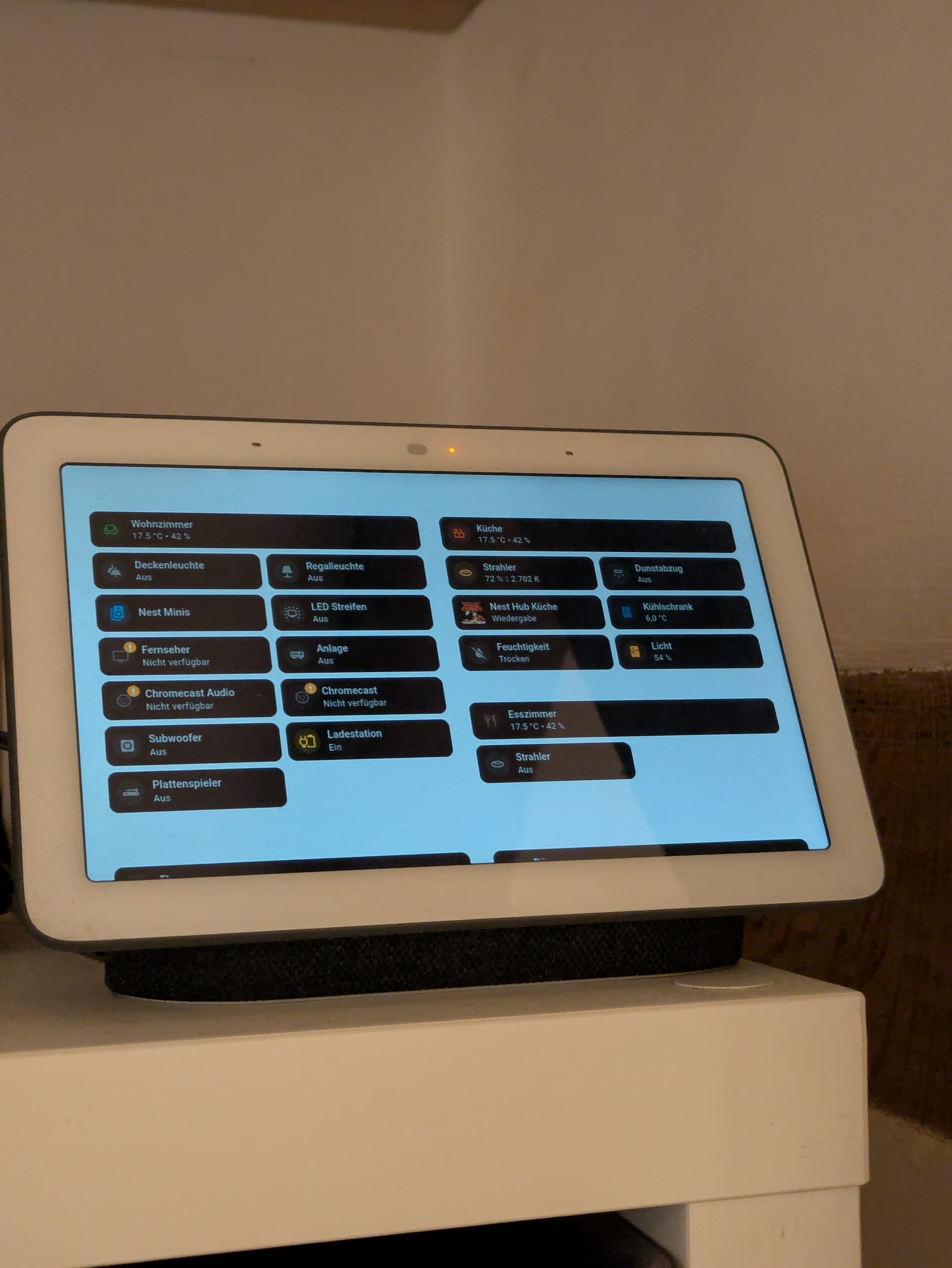

I’m having an issue with the dark mode on my Nest Hub:
The dark mode gets somehow butchered when I cast my dashboard, is this rather an issue of HASS or of the blueprint?
Home Assistant is running at the latest release 2025.1.3. I tried already to re-setup the blueprint, but with no improvement
For me the dark/bright mode is working now.
