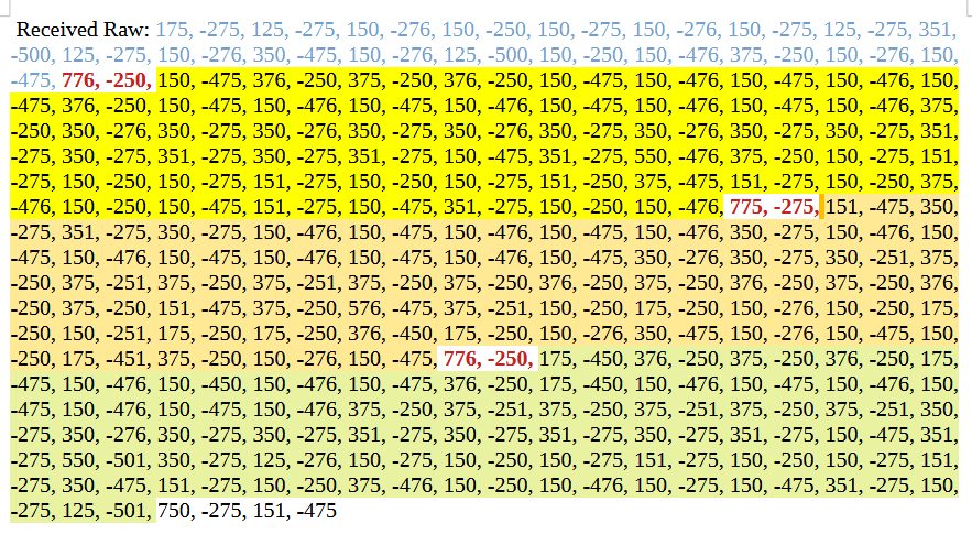

may I ask you how you did analyze the received raw code?
I’m trying to catch and resend a rf signal from a 868MHz command for shutters, but I don`t know how to do this. meanwhile I catched the signal on 868.35MHz / 2-FSK in raw and pronto.
The other thing is that the signal is always different, might it be a rolling code (what I not really can belive) or a lot of noise? The IC on the command is a CMT2157A.
raw

[12:49:06.833][I][remote.raw:041]: -476, 150, -275, 150, -475, 151, -250, 150, -475, 376, -250, 150, -275, 150, -476, 775, -275, 150, -476
So you don’t know if the signal is OOK or FSK??
no. to be honest, I havn’t got a glue.
yesterday I didn’t receive signals on ASK/OOK and today I was trying FSK and got a signal, thats why.
It looks more OOK than FSK. But it’s not decodable to my opinion…
I wrote OP’s signal was clean and easily readable. You can read the binary here:
2159, -4305, 437, -427, 641, -1068, 649, -1066, 661, -1069, 649, -1064, 644, -1075, 650, -1067, 661, -1072, 650, -1068, 430, -414, 446, -420, 640, -1082, 640, -1088, 433, -416,…
After header comes 01111111100110…
Yours is so messy I can’t get data out of it. Why, I don’t know. Could be some parameters, like frequency, are too much off…
Of course you can try to just send it like that.

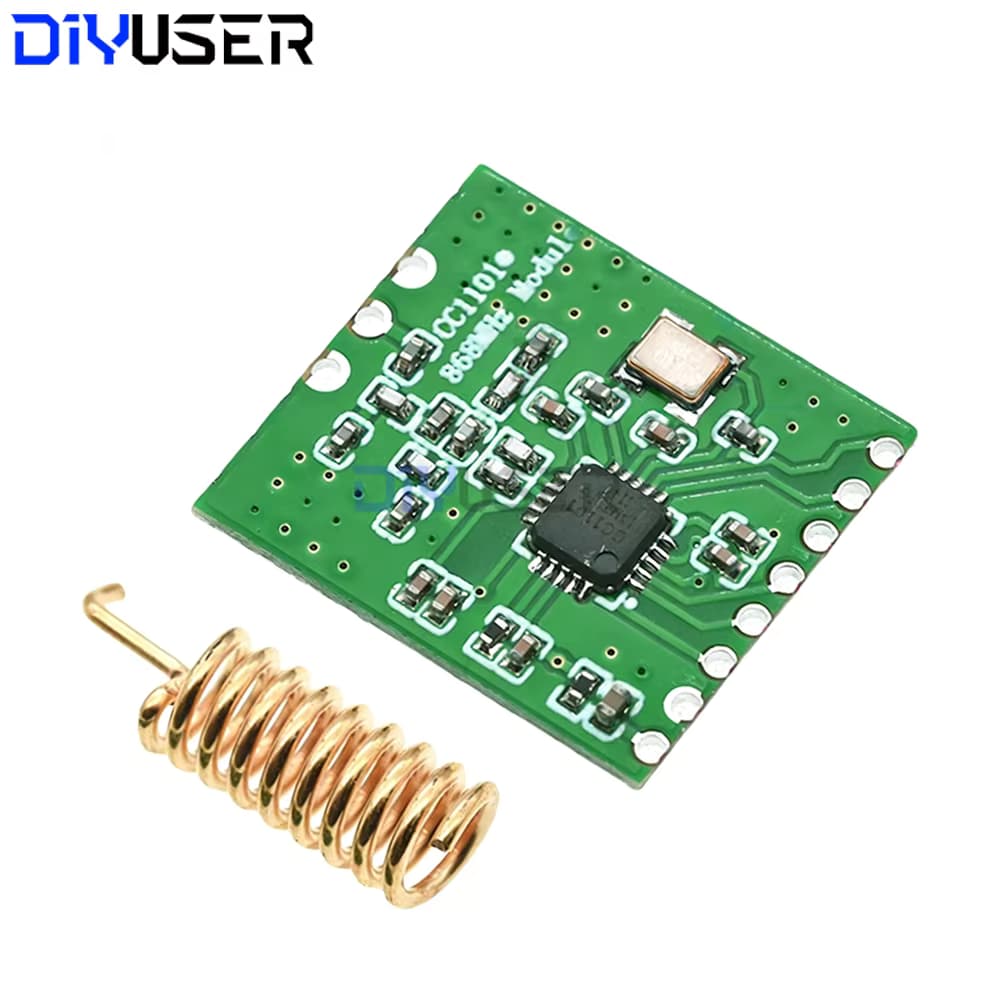

Is your cc1101 module built for 868 in the first place? If yes, did you try to adjust parameters, like frequency 868.0 or 868.7?
the module is for 868MHz.

I had your signal open on my notepad tab and while got bored I had a look another time. I noticed the ~775, -250 header and mess cleared up little bit right away.
There’s nothing wrong with the reception.
It’s PWM type of signal, either short,-long or long,-short. It’s 56bit signal repeated 3 times with preamble at the beginning.
Whole binary would be:
0111 0000 0100 0000 0011 1111 1111 1111 1101 0110 0000 0000 1010 1000
In Hex: 70 40 3F FF D6 00 A8
Edit: It’s little bit trickier than I thought. While every repetition is perfectly identic, within the signal there is shift in modulation between beginning part and end part…

If you prefer to keep on, post separate single signals that have different button state.

Anyway, it is not rolling code, both up signals are identic and down signal are identic.
Bits 0-30 are address, maybe serial number plus manufacturer code. Same for all signals.
The command itself is on bits 31-33.
Then there’s the weird part on bits 34-35 that I don’t understand, but RF signals are sometimes really weird. After that there’s tail that is always same.
