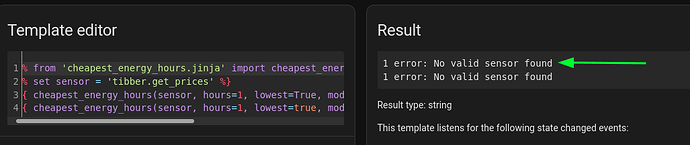

Hi there,
My goal is to create an average cheapest energy hours of 3 hours.
While reading the docs I can’t find out how and where to implement the tibber source sensor. Should it be in configuration.yaml or as my other sensors in the sensor directory? I have succesfully installed cheapest energy hours through hacs.
If you have them in a sensor folder, it sounds like you’re still using the legacy format.
This Tibber sensor uses the modern template sensor format. You can paste it directly in your configuration.yaml if you don’t use the template: integration in there already

Hi there,
My energy provider is tibber and I use the source sensor as suggeted in docs.
While running the action Tibber: Get energy prices in developer tools, the response is as expected:

but im not able fetch data no valid sensor found.
What am i overseeing?
tibber.get_prices is an action, not an entity. You need to create a trigger based template sensor as described in the documentation which you can the use as source of the macro.
