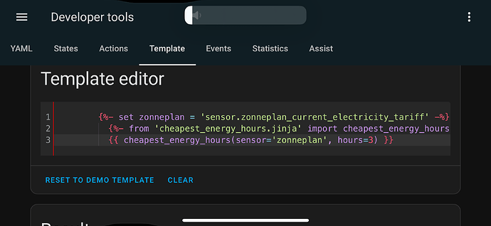

I’m quite new to the HA community but trying to get this working and bumping into a problem.

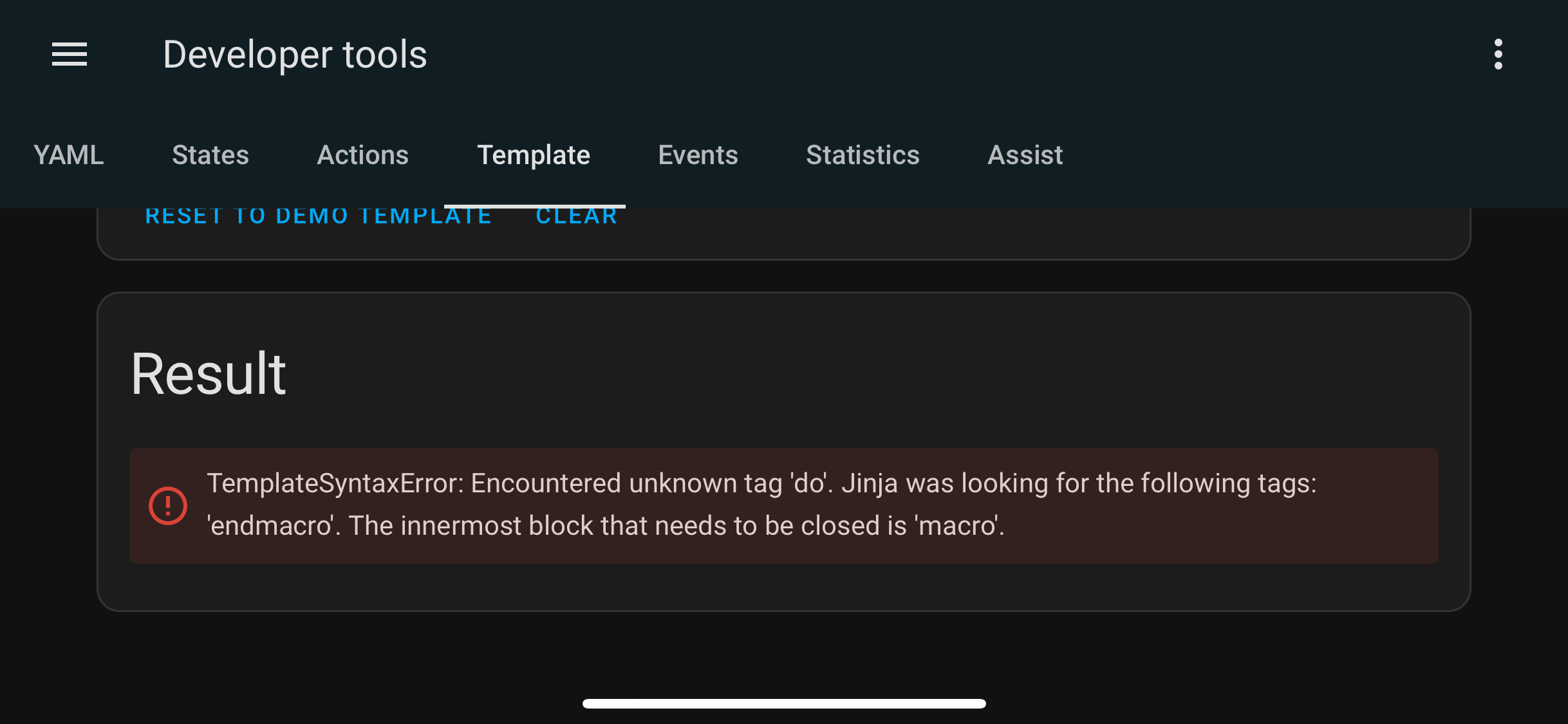

Problem I get when trying to get some output via dev tools is find in the screenshot below.
I have HA installed via docker on my Synology NAS. Also I have HACS running and installed the macro. I’m not able to enable experimental features in HACS but not sure if this might be the problem?
Your HA version is too low.
The functionality added in v7 to return native types requires at least HA 2025.6
If you’re unable to update, or dinner want to update for some reason, you can use v6. Note that versions 6.0.4 introduced a bug which now surfaces due to the ending of daylight savings time this night. I fixed that in v7.0.2, but it you want to use v6, you can use v6.0.3. As of Monday, v6.0.4 and later should work again, so you could update to the last v6 version then, which is v6.0.6.
