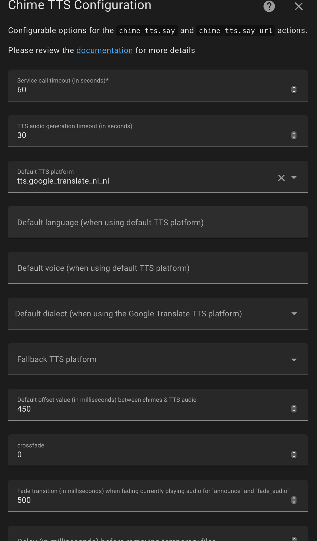

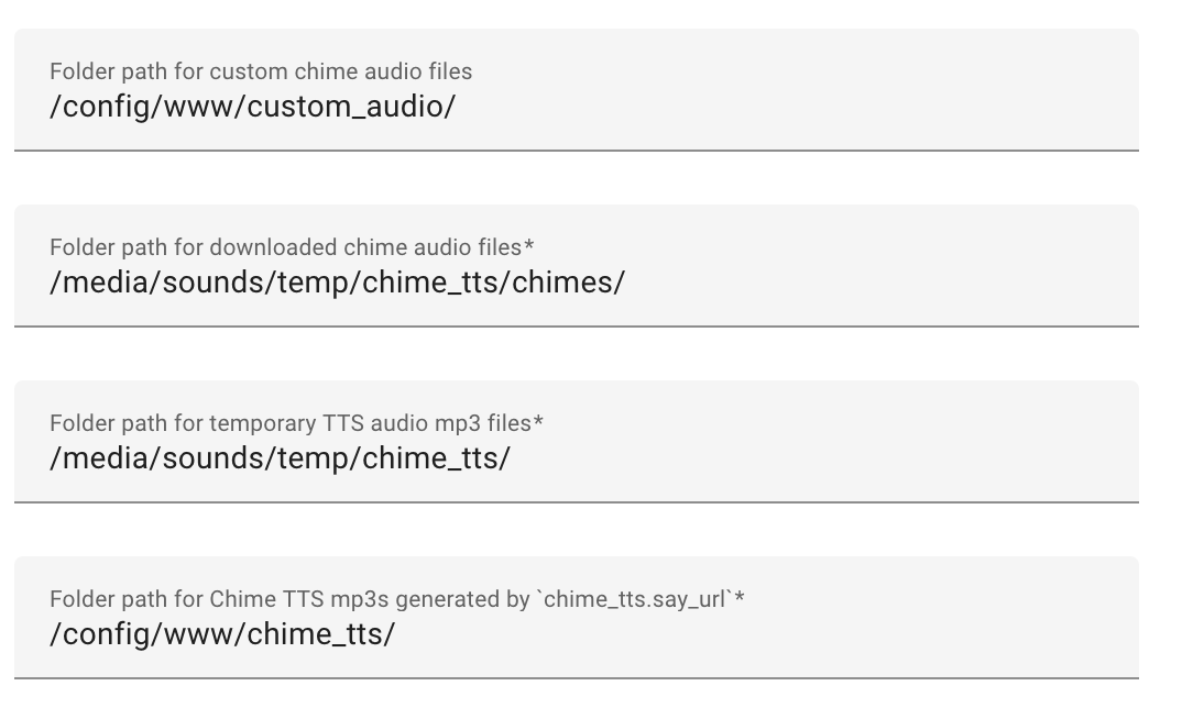

I updated the config for chime:
But pick list is still not populating:
Suggestions for troubleshooting?

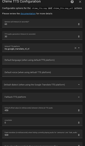

Hi Everyone,
I really love Chime TTS especially the announce function which I really want to use. But after an initial succes of setting up Chime TTS on my system of 4 Sonos one and 7 AirPort Express airplay 2 devices. After a weekend away from the house trouble started. Only one of the sonos devices would still play the Chime TTS script that I made and none of the airplay devices would work.
First I found out that the Sonos players were getting an IP ban due to expired URL tokens and I found the workaround for that in this topic https://github.com/home-assistant/core/issues/88714#issuecomment-2692173073
Now I am wrecking my head over how to get the chime_tts.say function to start working again on my airplay 2 devices. I can get a direct google translate TTS and also a chime_tts.say_url function to work. But if I want to call chime_tts.say then the below connection lost error logs appear and the sound does not play, were it did play perfectly before. Below is the script that I use, it works now on the Sonos players but not on the airport express airplay2 devices:

I have made debug log too, but it is very long and do not see how I ca post it.
Would anyone be able to help me get this going again? It seems like there is an issue with being able to play the local temporary file because any other media does play, and also I can play a local file from the chime tts folder in the /media/sounds/temp/chime_tts/ folder. But the file that I find there strongly enough is an old TTS file that was created when the script was still working more than a week ago.
I really love the announce feature and how it even works over external audio played via airplay by another source, which is why it would love it to start working again!

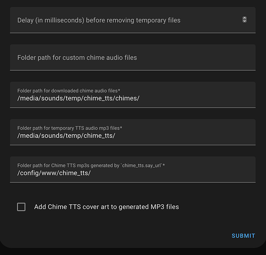

I get this error:
An OSError occurred while creating the folder ‘/media/sounds/temp/chime_tts/’: [Errno 13] Permission denied: ‘/media/sounds’
I’m using home assistant in a docker container.
I’ve added this in configuration.yaml, but it didn’t help. Same error message:

Hey @danwie, sorry you’ve been having issues.
It indeed looks like you’re dealing with a permissions issue. I’m no docker expert but perhaps you could open up the permissions on your /media folder to allow Chime TTS to read/write file there?
Try running: sudo chmod 777 /media to allow read/write access
Hey @Stubborn.
After you set the /media/Media folder path for your custom chime audio files, did you restart Home Assistant?
If you did, and they still aren’t added to the dropdown list, it might be due to a folder permission issue…or something else. Can you please enable debug logging, restart Home Assistant, and provide the debug log messages? Hopefully they might shed some light on what the issue is.
