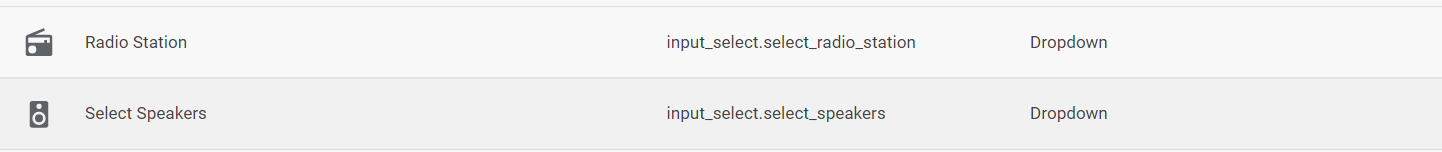

I’m using this script
alias: Play Radio on Chromecast Audio
sequence:
- service: media_player.play_media
data_template:
entity_id: >
{% if is_state("input_select.select_radio_station", "Kitchen") %} media_player.kitchen_display
{% elif is_state("input_select.select_radio_station", "Living Room") %} media_player.kitchen_speaker
{% endif %}
media_content_id: >
{% if is_state("input_select.select_radio_station", "BBC Radio 1") %} http://bbcmedia.ic.llnwd.net/stream/bbcmedia_radio1_mf_p
{% endif %}
media_content_type: 'audio/mp4'
Along with input select
but when I execute the script, nothing happens on my Kitchen home hub. There are no errors when I reload scripts so not sure why it doesnt work?
