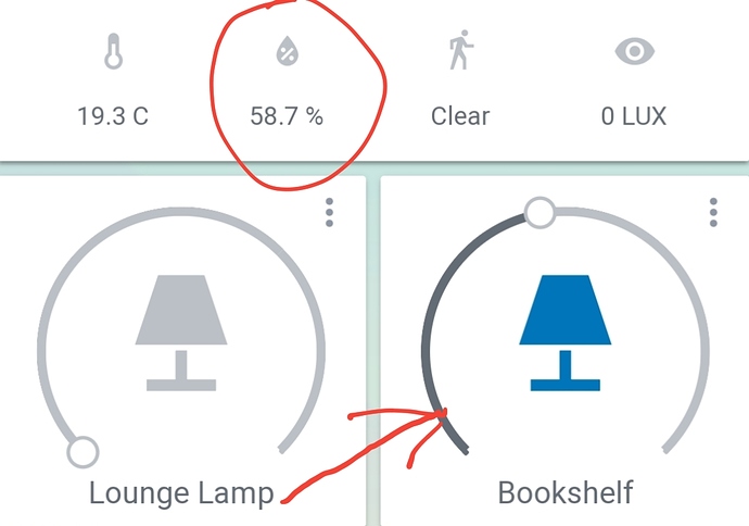

This theme is pretty close to exactly what I’m looking for, a nice clean material type style (yeah, I’m a Google fan boy :man_shrugging:
But it’s not quite looking like the screenshot
And what variable would I change to change the colour of an active light card, like I’ve highlighted?
And the colour of the header bar?
Many thanks for the awesome work!

I did not tried the header bar yet. But I think white fits well?
The lamp icon will have the correct blue color (accent-color) if you set the light to full brightness. If you dim it down, home assistant will dim the icon. Therefore you see a darker blue.
