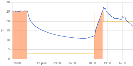

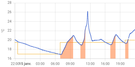

Hi, I’ve also been experiencing this very frustrating issue of a generic thermostat behaving erratically (eg thermostat is enabled (heating) on ‘comfort’ preset at a 20°C target, but switch stays inactive even when temp goes 4°C below target with a ‘cold’ tolerance of 0.5°C). This behavior is unpredictable, because sometimes it does work as expected too…
Interestingly I have two independent generic thermostats, controlling two distinct heaters in two rooms and different temp sensors. The first works exactly as expected, the on/off switch being via MQTT. The second is erratic, the on/off being via a Shelly1 Wifi relay (using CoIoT protocol, whatever that is).
Having noticed the erratic thermostat has fine interruptions in the orange colored “heating” under the temp curve, I’m wondering if the erraticness might be due to some communication issues between HA and the remote WiFi switch.
Screen shots of the two thermostat graphs showing the interrupted orange area under the curve for the erratic instance :
These discontinuous orange areas under the curve are also visible further up in the thread associated with the exact same erratic behavior of the generic thermostat.
I’m making changes to the way the Shelly communicates with HA, I’ll report back if this confirms or even solves this issue.
Come to think of it, I wonder if the workaround proposed bu the OP (tying the thermostat to a boolean instead of the actual switch) might work by providing the continuous stability generic thermostat requires to function correctly (ie hiding the HA-switch connections interruptions from the thermostat’s view…).
I’ve fixed the network link from the HA raspi to the WiFi Shelly switch (as seen with the uninterrupted orange fill beneath the curve, the single light colored vertical line is when I rebooted the HA host).
But as can be seen on the graph, the bug persists, it is now 2°C below the target temp of 20°C (cold tolerance of 0.5°C).
