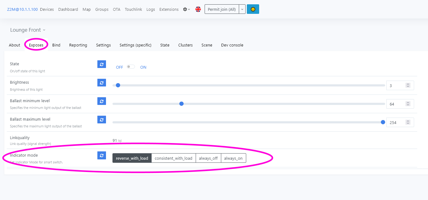

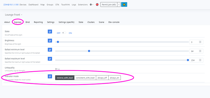

Is it possible to change/control the light indicator on the zigbee light switch through HA ? Seems possible if you have the Wiser hub- which i don’t have?
In zigbee2mqtt you do it here:
No idea about ZHA.
Thanks for replying, cant seem to find it in HA
It’s not in HA. It is…
Go to the add-on web interface, if you are using zigbee2mqtt. You still have not told us if you are using that or ZHA.
