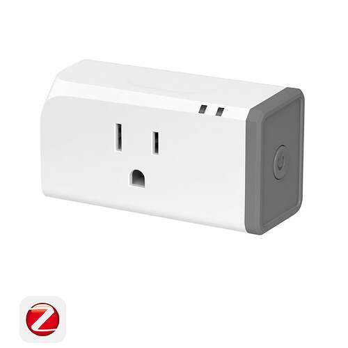

Your baseband heaters draw 1500watts, and the SONOFF S31 is rated for 1800watts, so it should be ok to use to switch one heater per S31 per 20Amp circuit with a small margin for safety. Be aware the S31 talks WiFi, not ZigBee protocol.

I have several zigbee INSPELNING smart plug (E2206), they are fairly cheap, available at your local ikea and very reliable in my experience, although I don’t know off hand what they are rated for, I assume similar to the s31 (which I also have a couple of).
Having both, I prefer the inspelning/zigbee over the s31/wifi, given the option I choose to avoid iot over wifi whenever possible.

Thanks for the info. Sonoff appears to make 2 different S31s, a ‘Lite’ that is Wi-Fi and one that is for Zigbee. They don’t make this very clear, I almost ordered the wrong thing.
Oh my! Point me to the place on their web page where it makes that clear? It doesn’t! Even in the user manual it shows both models (always together as S31/S31 LITE) and WiFi only is mentioned. Quite misleading. Shows how careful you have to do your planning, and even vendor web pages can be misleading.
You actually have to search out the Zigbee version (the S31 lite ->zb<- [as opposed to S31 LITE] which doesn’t have power monitoring and costs slightly more)
Most likely the zb model came along later, and they haven’t gone back to update the original web page or user documentation for the S31/S31 LITE.
