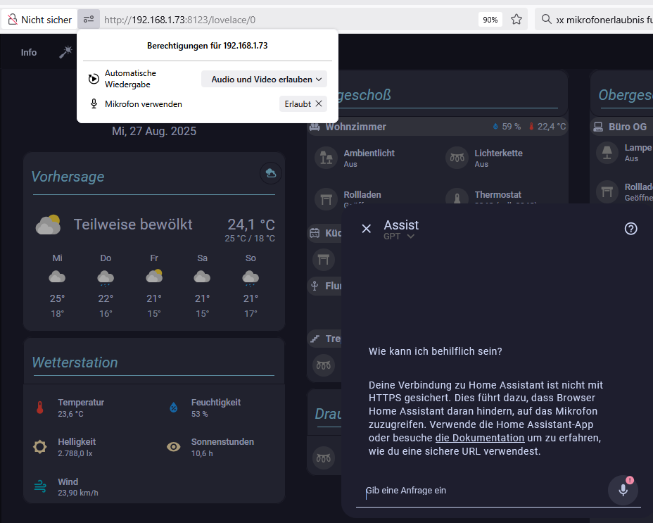

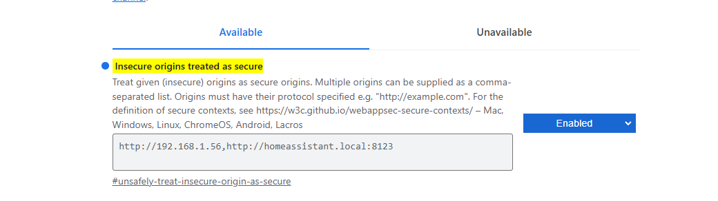

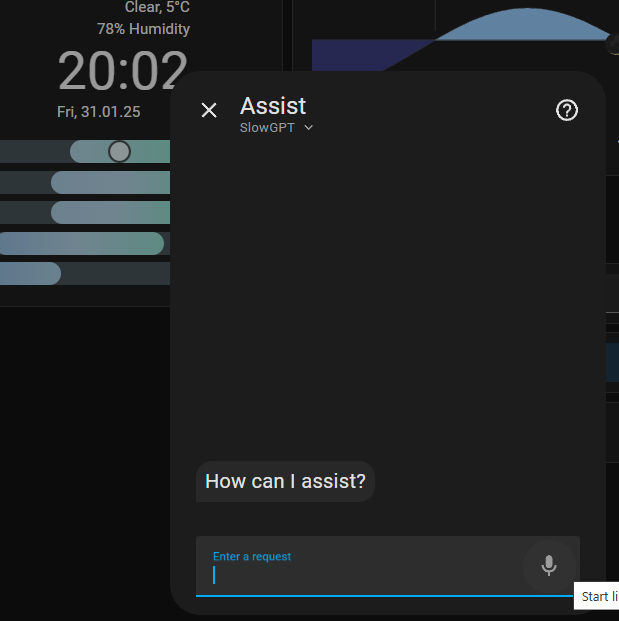

Looking at this long thread, seems that some of us are here due to the need for microphone access. I bypassed the limitation by allowing the browser to access the microphone for my HA only. while some of you will not like it, it does get things up and running.
I’m using Chrome / Brave, so just go here:
brave://flags/#unsafely-treat-insecure-origin-as-secure
or
chrome://flags/#unsafely-treat-insecure-origin-as-secure
write down your IP/local address and refresh HA page and change it to “Enabled”:
now, your microphone can be used:
hope it helps.
Goodluck
Sad thing about enabling this is that each time you open browser shows annoying warning message… (at least in crhrome and edge)
