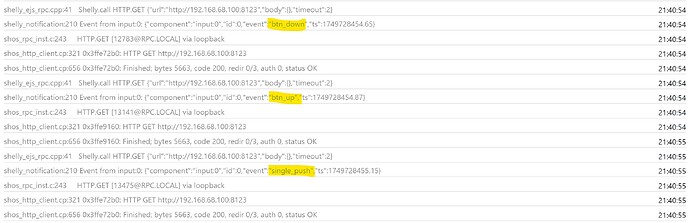

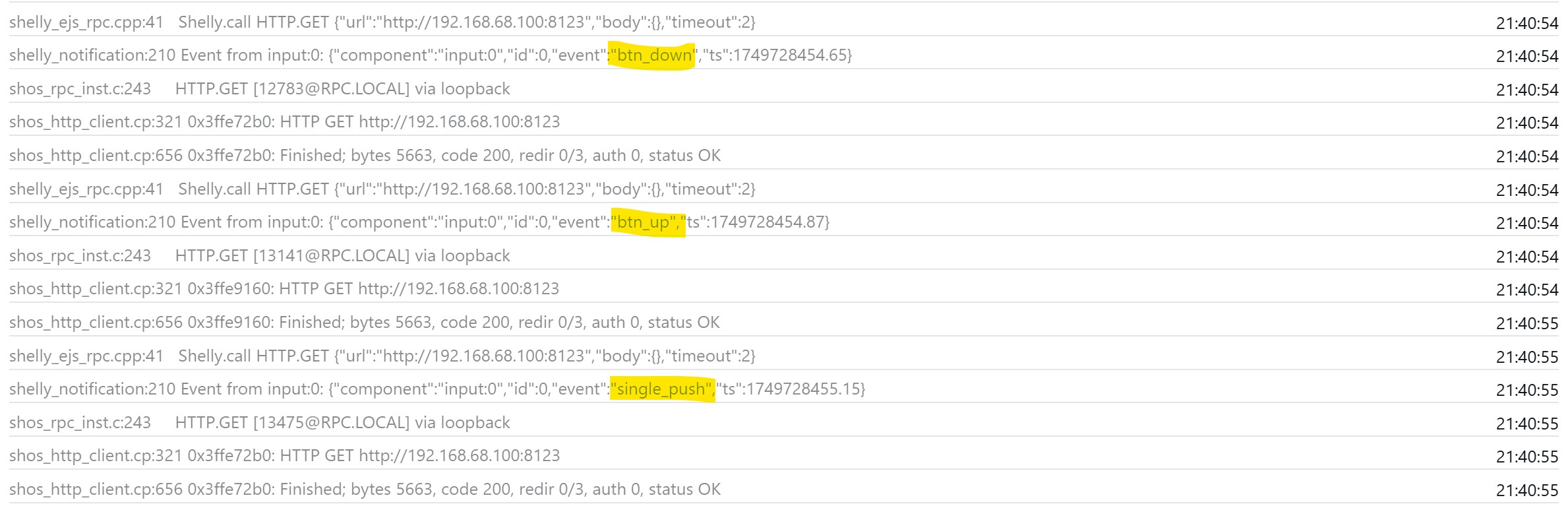

So I choose a different approach using a fallback method. On every input event (toggling the switch), it checks if HA is reachable, if not, it programmatically sets to relay to the switch’s state. You can keep the switch setting in detached mode.
let switchId = 0;
let url = 'http://server:8123';
function check(event) {
  Shelly.call("HTTP.GET", {url: url, body:{}, timeout: 2 }, function(resp) {
    let reachable = (resp && resp.code === 200);
    if (!reachable) {
       print("override switch behaviour");
       Shelly.call("Switch.Set", { id: event.id, on: event.info.state }, function(){});
Shelly.addEventHandler(function(event) {
  if (event.name === "input" && event.id === switchId) {
    check(event);
This approach is great! The issue I’m having is that I’ve got my momentary switches, rather than “Switch.Set” I’ve used “Switch.Toggle” which works, but because it’s momentary I get three events per button push to the lights flash.
Is there a way to only get the HA check to occur only when “event”:“single_push” occurs?
