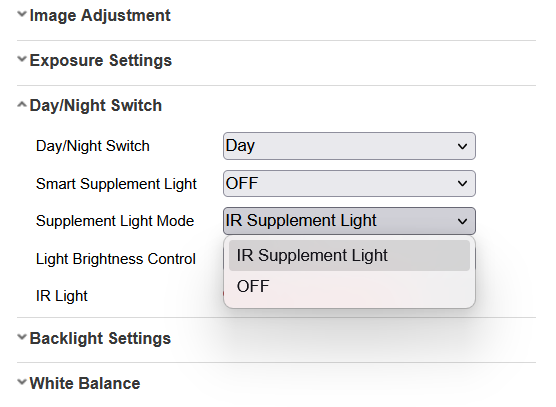

Reviving this because i’m struggling to get it working, it seems that my cameras, althdough they have lighs that i can activate from the hikvision app, don’t work with the curl’s listed here
The model is: DS-2CD2T46G2-ISU/SL 2.8
And in the settings i have this:
how can i move forward with this?
