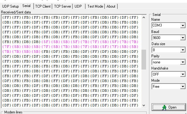

For the life of me, I could not make heads or tails of the read eeprom responses - they do not seem to reflect the brew counter counts shown on the display. Also the tray water/status is inconsistent and not representative of the machine.

For the life of me, I could not make heads or tails of the read eeprom responses - they do not seem to reflect the brew counter counts shown on the display. Also the tray water/status is inconsistent and not representative of the machine. The commands do come back starting with a lower-case of what I sent… so it’s not a serial line readback issue as far as I can tell.

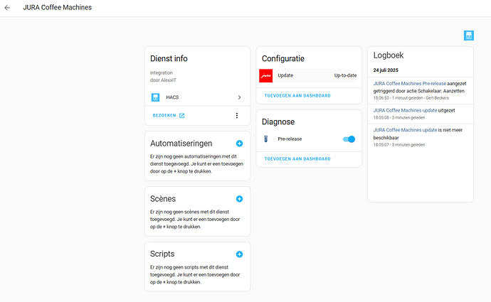

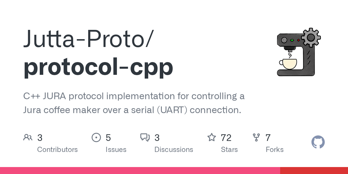

Hey, I’ve had a Jura impressa F7 (F-series) for years and have been running a variant of the RyanAlden github code on it for years. I run it on a Wemos D1 as the post starts.
But in the past few weeks I’ve made a lot of improvements to it. I can now read a lot more sensors (almost all counter positions!) namely:
  • Single espresso
  • Double espresso
  • Single coffee
  • Double coffee
  • Single cappuccino (*)
  • Single ristretto (*)
  • Double ristretto (*)
  • Movements of the brewing unit (*)
  • Cleanings performed
  • Descaling performed (*)
  • Number of coffee grounds in the drawer (*)
(*) all these sensors are new compared to the original esphome interaction from Ryan Alden
I also optimized it more for the small SRAM memory that a Wemos D1 (8266 chip) has. I’m going to continue with it myself. i still miss the counters for:
  • hot water
  • steam usage
i also want to port it to an ESP32 chip so you can use more SRAM and have a separate dedicated UART port.
It’s still a work in progress, so if you have any improvements, feel free to post a pull request or “issue” on github!

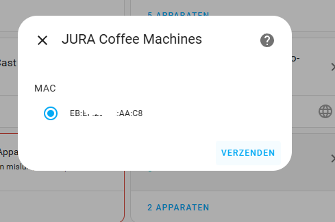

When integrating the HACS jura integration, I only see the screen below. My machine is Jura F7.
Anyone knows what might be the situation here?
The MAC address was visible:

Hi everyone,
First of all, I want to thank you all for the great work you’ve done on the Jura program — really impressive job!
I have a Jura Z10 with a Wi-Fi module, and I’m trying to inject data directly via UART (I soldered wires to the pins) just to test if the coffee machine responds to any input before diving deeper into protocol analysis.
For testing, I’m sending encoded data corresponding to the command AN:02, as follows:
5F5B 5B5F 7B7F 5B5F 7B7B 7F5B 5B5B 7F5B 5F5B 7F5B 5F7F 5B5B 7B7B 5B5B
Decoded:
5F5B 5B5F → ‘A’
7B7F 5B5F → ‘N’
7B7B 7F5B → ‘:’
5B5B 7F5B → ‘0’
5F5B 7F5B → ‘2’
5F7F 5B5B → ‘\r’
7B7B 5B5B → ‘\n’
Unfortunately, the machine doesn’t respond to these data — no turns off the coffee maker.
Has anyone here already tried communicating with the Z10 model this way and can confirm if this encoding or command format is correct?
Or does Jura require some kind of initial handshake or authentication before it starts accepting UART data?
Thanks in advance for any hints, and once again, huge respect for all the amazing work you’ve done on this project!
Hi Miro,
Unfortunately the UART communication method doesn’t work on (most? all?) newer Jura machines, because they have implemented some sort of yet-unbroken encryption, see here for details. Fortunately, the Bluetooth method works perfectly.
For the Z10, you’ll need the Jura Smart Connect Bluetooth adapter (the blue one, instead of the white Wi-Fi one), and also a way to send Bluetooth commands from Home Assistant (a Bluetooth Proxy using an M5Stack or Shelly device are both good options). Finally, install the Jura Coffee Machines integration via HACS , and configure Bluetooth in HA.
BTW if you feel comfortable opening the Z10, you can add a Shelly with relay running ESPHome and get power-on control as well. I use this setup with the Bluetooth proxy on the same Shelly, mains-powered, wired up to the power button inside the Z10.
