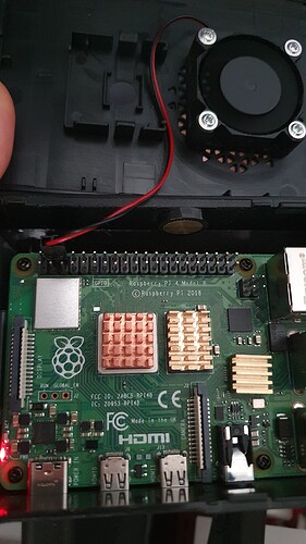

I’ve just added a Pimoroni Fan SHIM to my Retroflag NESPi 4 Case as the existing fan was too noisy and permanently on.
The rpi gpio integration worked beautifully.
my fan is connected to GPIO 4 (red wire, with the black wire going to GPIO 6, i.e. ground) so I used port 4. But my fan remains on no matter what, even if I toggle the switch manually. What am I missing?

Looks like the pins you are using are always on.
Can’t smart-control a dumb fan unless you do some modification. Cheapest would be my current setup, detailed in this post. Takes minimal soldering skills and extremely cheap electronic parts.
