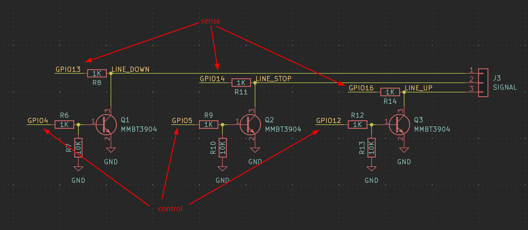

Hi there, sorry to resurrect an old post of yours, but I was hoping you might be able to elaborate on exactly how you wired the 'sense wires on the ESP module to show state. I can see from the config code on your Github that three sense wires each connect to GPIO pins on ESP module, but where is the other end of the wire connected? Do they also require resistors to be inline?
I am using a Wemos D1 mini to control my Velux Skylight using ESPhome. It all works fine, but I’d love to include the open/closed state for automations.
Thanks in advance.
Per button, one GPIO pin (here: control) controls a transistor to drive the line low, and another GPIO pin (here: sense) is passively connected to the line with a 1kΩ resistor to detect button presses coming from the remote side.
I’ve also added a PDF schematic to the Github Release.
