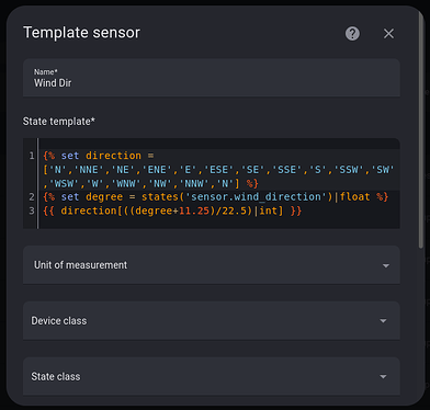

  1. create a helper called “sensor.wind_dir”
  2. Paste the code listed above in the state template field and it objects
    Which field am I supposed to paste the code into please?

When setting this up as a Helper:
The “State Template” field only accepts Jinja templates, use
{% set direction = ['N','NNE','NE','ENE','E','ESE','SE','SSE','S','SSW','SW','WSW','W','WNW','NW','NNW','N'] %}
{% set degree = states('sensor.wind_direction')|float %}
{{ direction[((degree+11.25)/22.5)|int] }}
Make sure to use the entity ID of your sensor if it isn’t sensor.wind_direction.
Leave all the other fields empty:
Thanks @GaryK, this was the step I was missing. Works like a bought one!

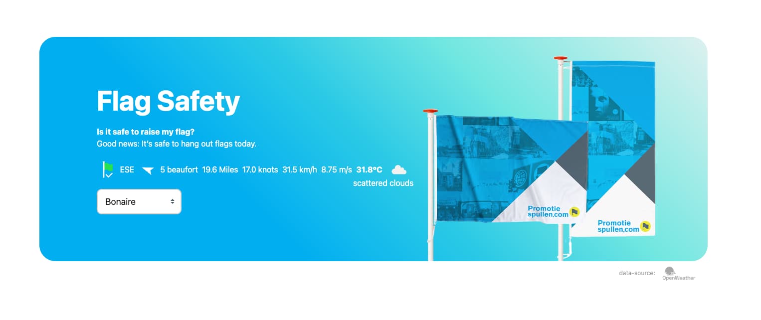

I use it for this simple wind check thing i made using data from OpenWeather
https://www.promotiespullen.com/windcheck
