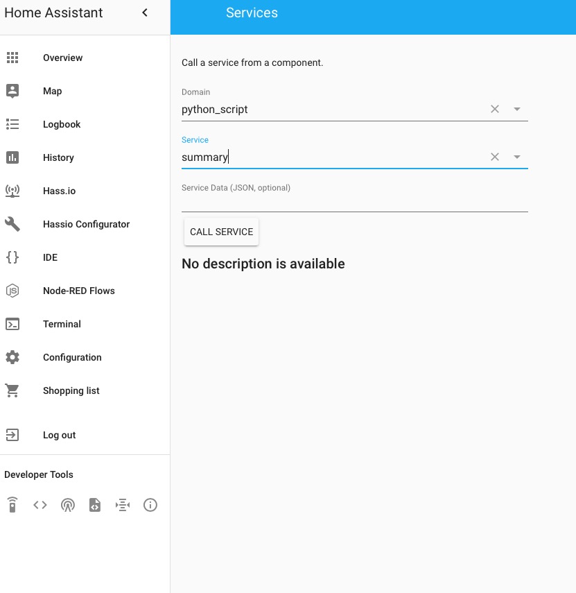

check my summary.py please:

took out some empty spaces in that line, and now the error shifts one up:
  File "/usr/lib/python3.6/site-packages/homeassistant/components/python_script.py", line 166, in execute
    exec(compiled.code, restricted_globals, local)
  File "summary.py", line 36, in <module>
  File "/usr/lib/python3.6/site-packages/RestrictedPython/Eval.py", line 35, in default_guarded_getitem
    return ob[index]
IndexError: list index out of range
Each groups_* needs have the same number of elements (all 3 or all 4)…
For each one it wll create a separate summary…
For example:
groups = [‘group.family’, ‘group.devices_to_show_in_use’, ‘group.devices_to_show_offline’ ]
Or if you really want only 2 summaries (home and in use), use something like this:
groups = [‘group.family’, ‘group.devices_to_show_in_use’]
and remove the 3 element of groups_* below.

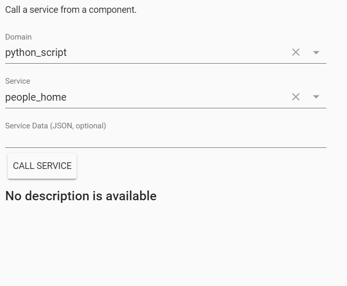

Hi!
Apologies in advance for my basic question, but I’m still trying to figure out what Mariusthvdb asked a few posts back: how do you display the sensor in the frontend?
I’ve added the original code as a python script in config/custom_components/sensor:
#count people that are home
home = 0

Do I declare the sensor in the wrong way? Or should the script be activated first (I can’t call it from ‘services’)?
Any help would be greatly appreciated!
HI!
from what I’ve learned here, is that the sensor.people_home is created on the go through the hass.states.set.
If it is, you should be able to find in the developers section <>, along with its state.
If yes, you can show it in a group.
if it isn’t there, you should get the script to run, since it apparently hasn’t yet. That too you can experiment with in the dev’s section: click services, select python_script, the right script (service) and Call Service.
if all went well, you should be able to see the sensor. If not the script itself isn’t correct (yet)
Hope this helps,
Marius
Your count people at home is indented by 2 spaces to many it should line up with the previous - platform statement.
Thank you for the quick replies!
I have removed the indents. This causes the weather icon to show up again.
Also, the script is moved to /python_scripts and that makes it visible in the developers section:
It’s also added to a group:
  home:
    name: People at home
    entities:
      - sensor.people_home
However, the sensor still doesn’t show up and also is not visible in the ‘states’ overview.
your sure the script actually ran? otherwise the sensor isn’t populated and thus not shown in the frontend.
