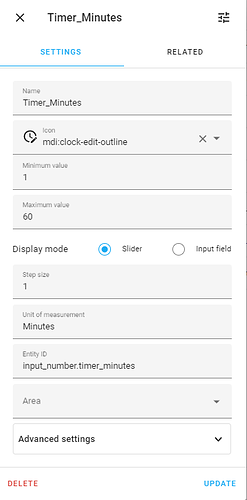

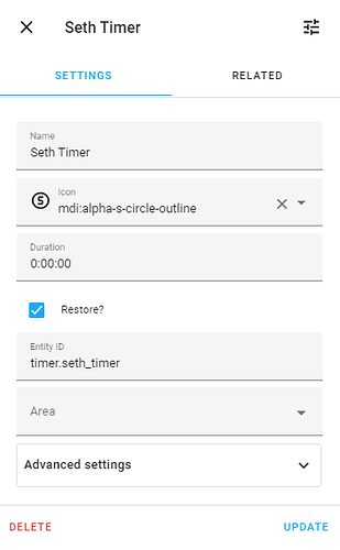

This is my script to start the timeer:
alias: 'Timer Start Seth '
sequence:
- service: timer.start
data_template:
entity_id: timer.seth_timer
duration: 00:{{ states('input_number.timer_minutes') | int }}:00
mode: single
icon: mdi:alpha-s-circle-outline
The timer and input number are just very basic helpers.
