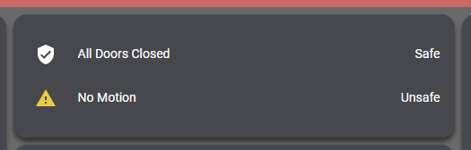

Here is how i did what i wanted to do, although something slightly different from the counting thingy:
Create groups with the device_class i want, automation to set them up on startup and a binary sensor to show them to me as safety

binary_sensor:
  - platform: template
    sensors:
      all_motion_sensors_off:
        friendly_name: "No Motion"
        value_template: "{{ is_state('group.all_sensors_motion', 'on') }}"
        device_class: safety
      all_doors_closed:
        friendly_name: "All Doors Closed"
        value_template: "{{ is_state('group.all_sensors_opening', 'on') }}"
#had to class them as safety in order to exclude them from the previous group
When at least one motion detector is on:
