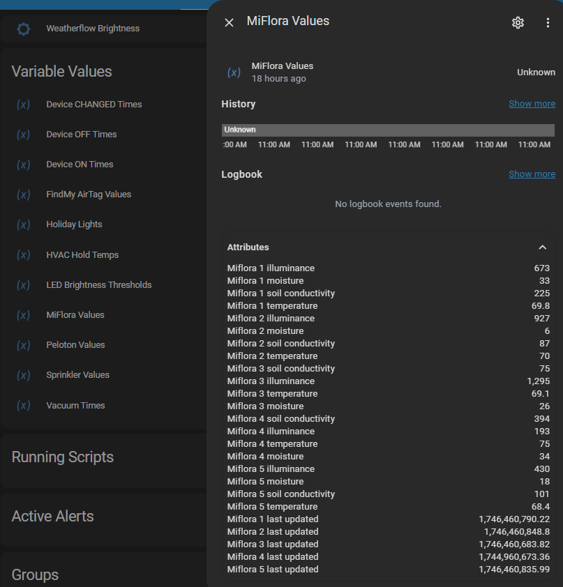

UPDATE. Now using GitHub - enkama/hass-variables: Home Assistant variables component - which is a fork of @rogro82’s original code. Local HACS link: https://homeassistant.local:8123/hacs/repository/307678069 Creates sensors.* vs. variable.* entities - so definitely needed to update quite a bit of code in automations/scripts/etc., but worth the change and still working as desired. IMO, still much ‘cleaner’ than having a ton of input_. entities in my setup.
Here’s how I’m currently using:
Example above shows some Miflora BLE moisture sensors. Automation populates the variable(s) upon update. Other variables shown on the top-left of image.
