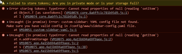

Alright, so time for the next big hurdle: CH5 apps do not support local storage or cookies to store data. I can get an iframe to partially load, but the actual Home Assistant UI will perpetually hang:
Curiously, this only seems to affect CH5 apps. General Web projects suffer no such restrictions, probably because it’d be a heck of a lot harder for any standalone app to work with that limitation.
So, right now we have a bit of a conundrum: General Web (EMS) mode supports local storage and can actually boot Home Assistant, but can’t access the full join table. CH5 apps can access the full join table, but block any sort of persistent data.
We still can connect to the Home Assistant API and set that up, so I guess custom-made dashboards and platforms would still be possible to some extent. Unfortunately, the lack of local storage also means that any credentials or configurations would need to be baked into the bundle… nowhere near as simple as an on-board config interface. Perhaps we can call in the HA Component Kit for an assist?
I’ll keep looking to see if there’s a workaround, but I’m not particularly confident in the moment. I suspect I can at least get Home Assistant proper running via a polyfill of LocalStorage, but there’ll still be other problems that need to be resolved. (Edit: yes, a polyfill works, and a bug report was opened for this).
Edit 2: For some reason, I apparently have access to IndexedDB, at least on a 1060. So, there’s at least some capability for persistent storage, but I doubt the Home Assistant project would be willing to add that for something so niche. Perhaps some extra code somewhere post-bootloader?

HA itself has a hard dep on needing (working) LocalStorage. See Frontend issue 25837 for the actual “bug” here.
It’d be awesome if there was a feature like an “embedded dashboard” in HA, where a full dashboard context could just be dropped in an iframe with no auth or any other provisions save a magic link. Would be absolutely perfect for this use case. Likewise, if one were to allow auth via IP address, that’d also be fine with a (far simpler) polyfill - just bind localStorage to sessionStorage:
Object.defineProperty(window, 'localStorage', { value: window.sessionStorage });

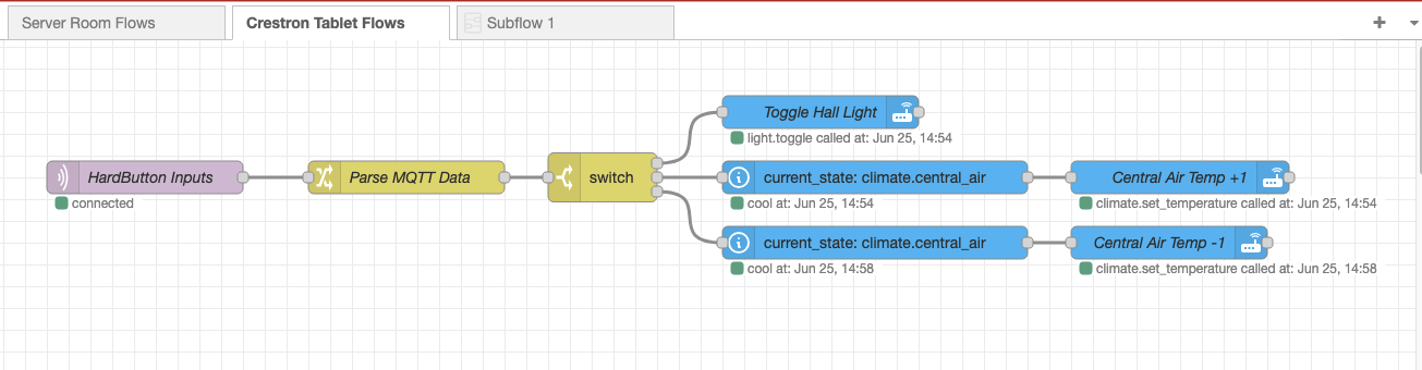

Meanwhile in status updates nobody asked for: have some videos! Crestron in Node Red is also a thing (and yes, plain-old automation templates also work).

For anyone else looking at this thread, I made a video detailing how to use Node Red to control the Crestron panels with Home Assistant. Happy to remove this message if mods here don’t like YouTube links.

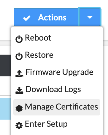

HTTPS is going to be annoying, since unless your Home Assistant has a publicly-trusted SSL certificate in the TSW’s store, you will need to load the relevant root/intermediate certificates:

When I visit the coldboot URL I set in VITE_HA_DASHBOARD_URL in Firefox, I see the “Crestron Tablet Cold Boot” banner - but the dev tools show an error running the Javascript “TypeError: can’t access property “onDataLoadComplete”, window.localStorage.__storage is undefined”
Unfortunately, I’m a C/C++ dev and have never touched TypeScript, so I don’t really have a ‘favourite TypeScript compiler’ as per the docs :slight_smile: - I might have compiled it incorrectly:
tsc polyfill_localstorage.ts --module nodenext -moduleResolution nodenext
