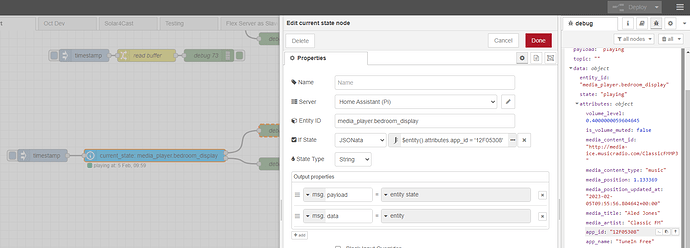

Sadly I don’t have your media_player and I don’t have your entity data to examine, however setting this up for myself this morning it all works nicely.
The entity is a media player (nest hub, now playing radio).
Using the output properties, I am sending the entire ‘entity’ object to msg.data. In the debug window I can see all the msg.data, and the attributes, and the app_id which is a string ‘12F05308’.
In the JSONata expression for the JSONata test, the $entity().attributes.app_id gets the entity data, and the attribute value for app_id.
In the JSONata expression the left hand side evaluates to ‘12F05308’ as a string. The right hand side is the same, therefore this expression evaluates as true. The output is on the upper ‘true’ output.
I can only suggest that you would benefit from doing something similar so as to check the entity value (as seen here in Node-RED and not in HA) to ensure that your app_id is actually ‘Netflix’. If it is, then I cannot see why this will not work.

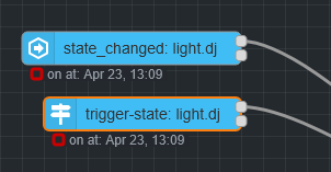

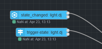

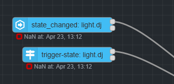

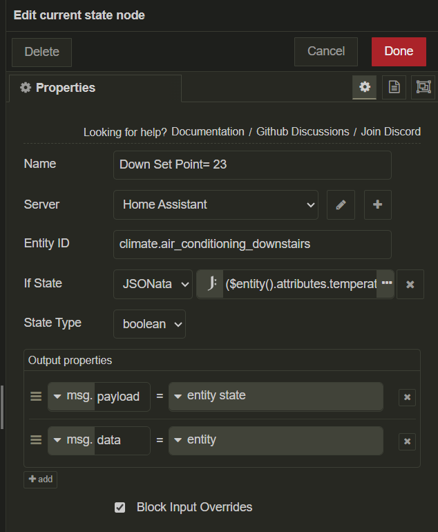

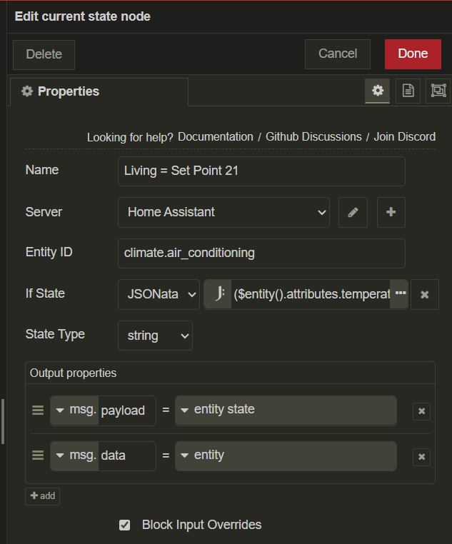

I am able to get the temperature set point attribute from my TADO climate Entity.
If State JSONata J: ($entity().attributes.temperature) = 23
State Type boolean
Behaviour:
  • Displays the word false if the JSONata is ‘true’ or ‘false’, due to the statement being false when compared against the entity.
  • The colour indicator does indicate Green for 'true and Red for ‘false’
  • The messages are directed to the right output
When JSONata is ‘false’
When JSONata is ‘true’
Unsure if there is a bug fix for this behaviour?
Maybe they need to develop an “attribute state” node
In your example I wonder how this works with state type set to "boolean? Aren’t you testing for a number? Might this change / improve the behaviour?
The behaviour of the node Lables is completely off when testing for attributes fro me too. I think this would have to be fixed by the NR devs in an update.
What you see under the node in text is the state of the entity not the result of the jsonata statement. State type also refers to the main state and not the jsonata statement.
If I use a bulb who’s state type is a string, set to string I see
Set as boolean (returns true because the light is on)
If I set it as a number, returns NaN because the state is on
The color indicates if the test passed/failed. Those all failed with the output to the bottom. They go green when the test passes.
The climate entity outputs a string as state, heat, cool, dry, off etc. I may be able to set the node as string and it will still work. Setting it as number returns NaN, Not a Number.

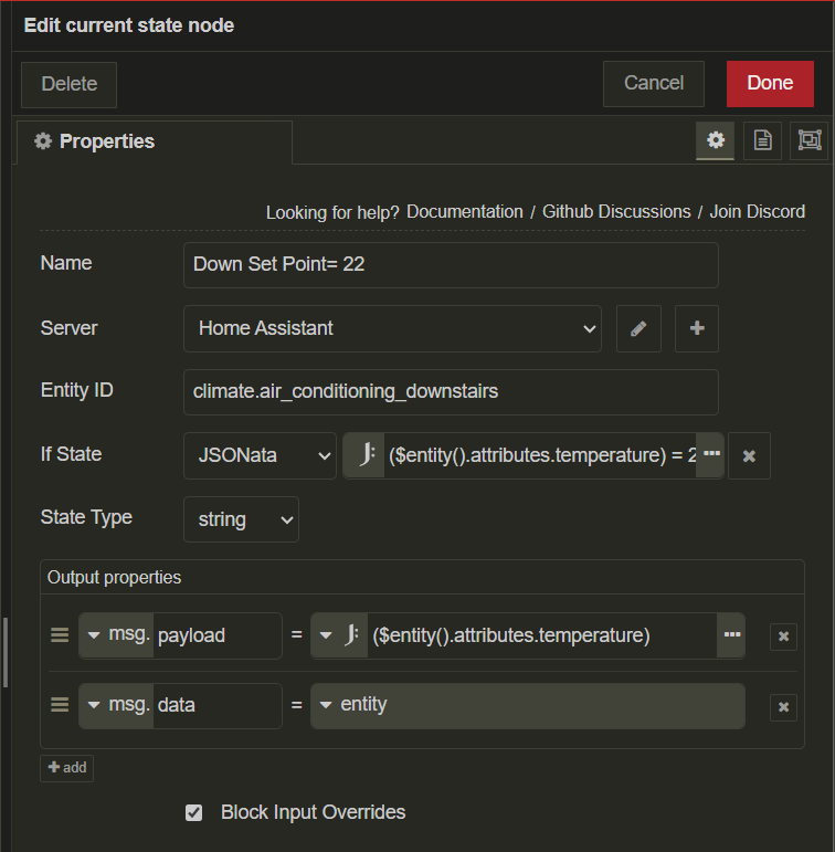

Just an update.
I changed my node to
If State JASONata J: ($entity().attributes.temperature) = 21
State Type string
Behaviour:
  • The Node displays the state of the string, as the climate entities state is a string, showing heat, cool, dry, etc.
    • NOTE: This does not control the output of the node with the JSONata being in in place
  • The colour indicator indicates Green for ‘true’ and Red for ‘false’ against the attribute in the JSONata expression.
I think I prefer this as I can see:
  • Word: State of the Climate Entity
  • Colour: ‘true’ or ‘false’ against the JSONata Expression
OUTPUTTING THE ATTRIBUTE STATE FROM THE NODE
To output the attribute state rather than the entity state
State Type string
Output properties
msg.payload J: ($entity().attributes.temperature)
Behaviour:
  • msg.payload = the state of the attribute.
