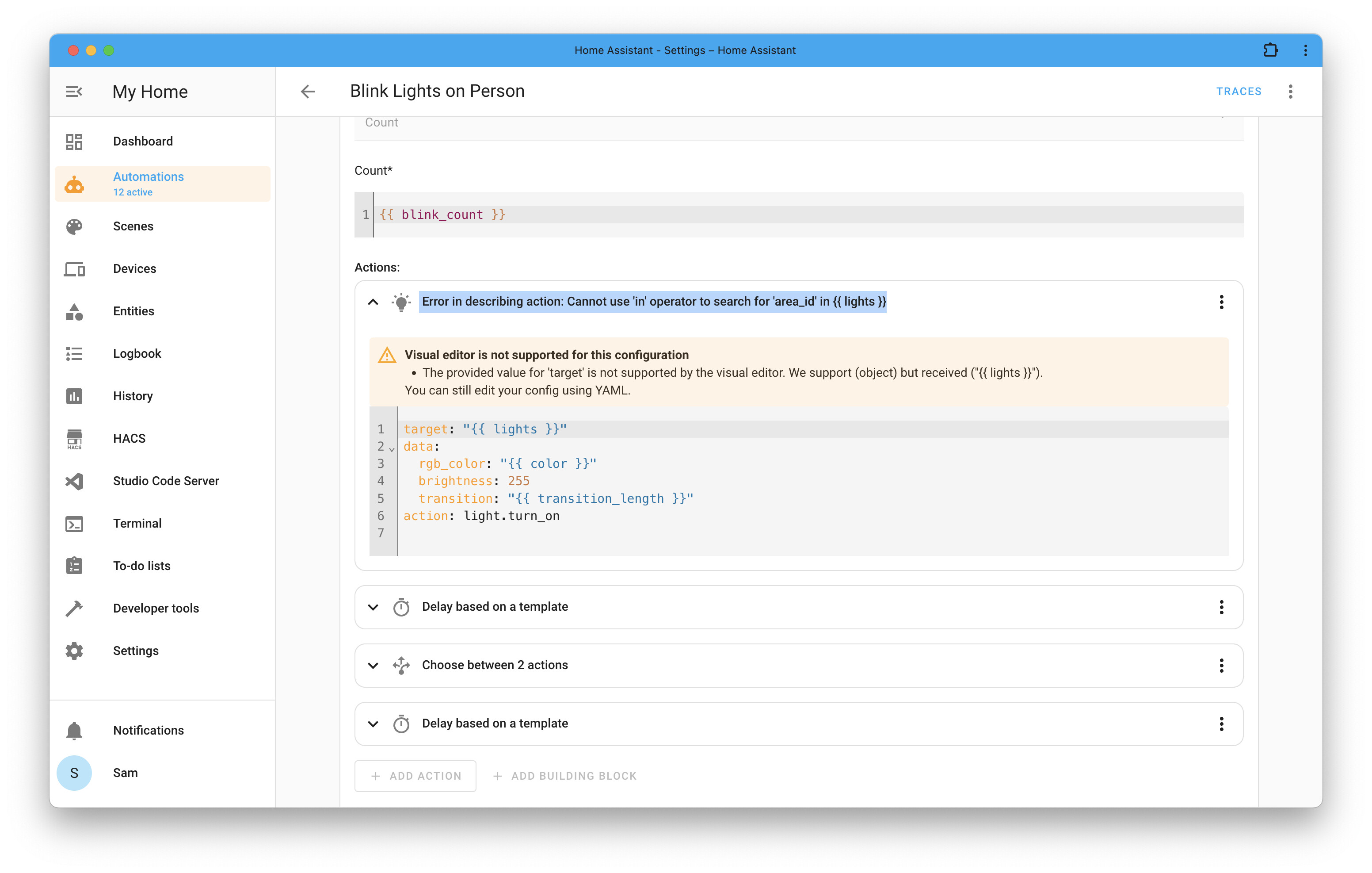

When viewing the automation I’m seeing the following error
