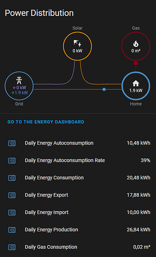

Iâll show you an example of how I do it to achieve this:
Hereâs the yaml code for daily/weekly/monthly/yearly sensors of production, import, export, consumption.
You will need to replace the sensors with the ones you have in your installation.
