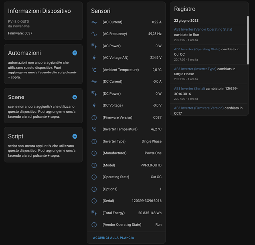

Buonasera,
i’ve recently installed this great component on my venv based HA to run a PVI-3.0-OUTD (VSN300). I’ve used for several years the native modbus component and decided to give your component a try. I’m using the attached configuration and everything works like a charm but sometimes the device goes offline and I got no sensor reading. It happens every 1/2 days and the only way to make it work again is through the configuration panel. I simply open it, click on “Invia” and sensor data appears by magic. Unfortunately I got no log data but I’ll try to add some more info. Thank you and complimenti !
