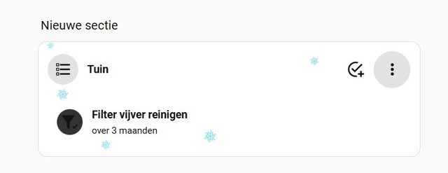

How do i get rid of the icon next to “Tuin”

Hi there - happy to take a stab at answering! I’m mostly just keeping this component functioning, but don’t have time right now to do any active development.
  • I don’t think I added a feature to remove that icon, so it might require a feature request
  • If you go to Developer Tools > Actions you can find an activity called “Update Activity”. You can edit the recurrence there.

ok i will add a feature to remove icon
