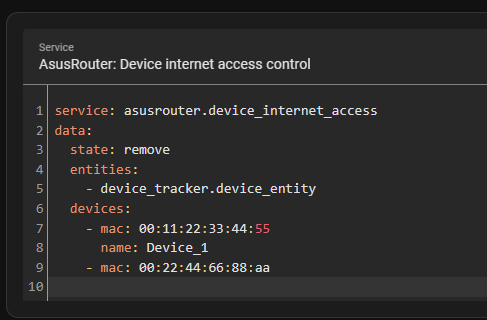

:framed_picture: Images and some details
Device internet control
Please, welcome back a refreshed service for parental control rules. You can use the HA GUI to set rules for multiple entities (by selecting corresponding device trackers)
Using YAML mode, you can provide your own list of devices by their MAC addresses (and optionally names)
P.S. You can also now set rules for both entities and custom devices at the same time
P.P.S. Yes, you can set only a single state at once, but to many devices.

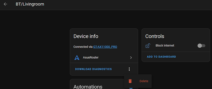

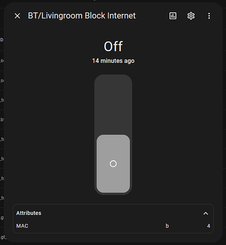

Internet block switches
New switches are now available for parental control rules - {device}_block_internet. And I hope that they are working the way you would expect - when set to On - block is set (so the device is blocked from the internet).
The new switches are much easier to use in UI or for automation so that you can save a bit on your automation YAML code. Moreover, you would now be able to watch the rule state directly instead of searching for the correct MAC address in the full list of rules.
If the rule is removed, the entity will become unavailable and you can remove it from HA. New entities will be created automatically when new rules are added.
Please, note, that if added/removed from HA service, entities should change state immediately. If done from the router itself (outside of HA), you would need to wait till the next sensors refresh (30 s as default)
Optional creation of devices for clients (when any entity is created for them)
Configurable / Default: disabled
Using a new option in the configurations (Configure / Connected devices / Create HA devices) you can allow integration to create client devices when creating any entities for them. This feature is disabled by default. If you would like to use it, enable it.
All the client devices can be removed from HA by the user. Please, keep in mind, that devices will be recreated if any new entity is created. This is a feature to remove devices with no available entities.

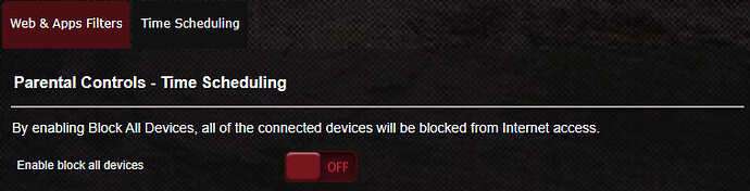

switch.gt_ax11000_block_internet
Does this mean that I block ALL internet or do I enable the option to block internet for devices that had been added for blocking to internet?
@poudenes,
it will block internet connection for all the devices connected through this router. This is the full analogue to this switch in the Web UI
For separate clients (even if for all of them), you can either use per-client switch entities (e.g. combine them in a group) or the service call

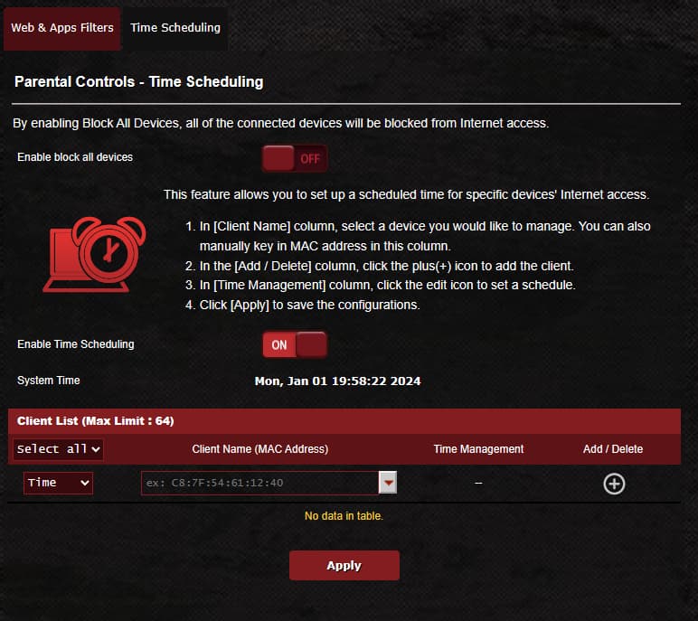

I do not see any Asusrouter services in the dropdown when I go into Developer Tools/Services?
Are the switch entities for specific devices created when you create the parental control rule in HA GUI? If not, how are device specific switches created?
Hello, @automateitall,
The switch entities are directly linked to the parental control rules in the device settings. So if rules are set for the device, they will appear in HA. Also, if you use a service to add new rules directly in HA, they will be written to the device + switches in HA will be created.
As per the services, asusrouter.device_internet_access should be available if your device is configured as a Router.
In case, it does not work for you when configured as a router, please, open an issue.
It’s currently not available in other modes the same way as the other parental control features. In case, you would like to have it working, please, let me know. I don’t have direct access to any device set up as an Access Point or Media Bridge, so I don’t know which features can work for such devices. But I can work on it
In any case, you should see at least the service asusrouter.remove_trackers available for any HA configuration. If not, please, open an issue with details on your device and HA configs set for the integration
