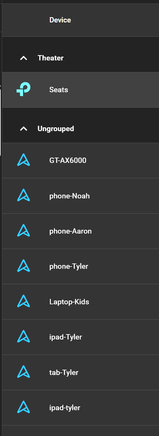

Hello! I want to know if it is possible to display in home assistant the vpn (openvpn) status of users connected to the Asus router.
Is this integration abandoned… it seems to have serious bugs.
I have tried multiple things, even removing and readding the integration completely.
When I do not use the filter, all router wifi devices get created.
When I try ‘Include Only’ and I select the 4 devices I want, the integration populates 3 devices correctly, 1 device is missing, and I have 5 others that I did not select!? Also, one of the showing devices does not create a device_tracker, yet the other 2 have them.
The config JSON correctly has only 4 MAC addresses which I selected. So clearly its a bug in the logic of the integration.
