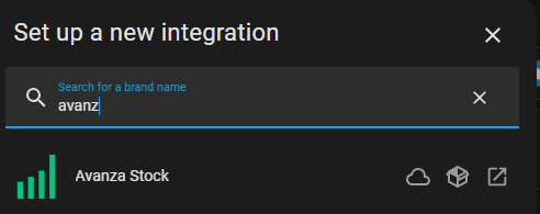

Hi, Could I get some assistance with setting this up please.
So far I have added sensors: !incude sensors.yaml to the configuration yaml and created a file called sesnors.yaml In the sensors.yaml file I have copied the example template and modified it with my share number. Where do I go from here. How do I see the data? The integration is not setup. When I try to add the integration it refers me back to the configuration.yaml
I am not familair with what I need to do with yaml code. I have migrated from Smartthings and learning HA. I mostly use the UI for automations etc.
First you need to learn how to install custom components (like this one). The simplest way is probably using https://hacs.xyz. I would also suggest to skip doing includes until you have something working in a single yaml file
Thanks, I have HACS installed and have installed the integration. I have many other integrations through HACS but these have a UI for configuration.
How do I setup this integration?
Well done then! I havent got around to make it possible to use the gui, I kinda prefer yaml myself
One error I can see directly is that you should remove “sensor:” from your sensor.yaml and the reindent so the “- platform
” is furthest to the left.
Under Developer tools there is a Check configuration button that hopefully will give you some meaningful information if something is wrong with your yaml config :slight_smile:
Thanks, removing the sensor: from the sensor.yaml code and re-indenting the text helped. I can now see the sensor value.
