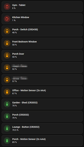

Try this, hopefully it’ll provide you a starter.
You’ll need to have the following custom cards installed: -
If the battery is managed by Battery Notes you will see the battery type in parentheses after the name and the icon tap action will prompt for confirmation that you’ve replaced the battery.
If the battery is not managed by Battery Notes then the card behaves like the normal Tile card (i.e. will display more-info)
