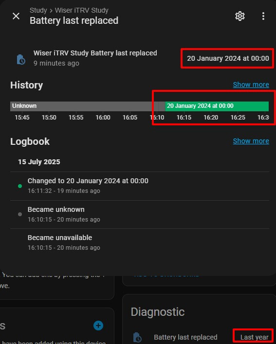

Hi and thank you for the integration. I was trying to add historical battery replacements which I was tracking just by making note on my phone, but it doesn’t I got unexpected results.
Firstly I was trying to do this by editing the state and ended up with below
I’ve tried deleting device to wipe the data but after readding device data returns - how can I delete all the data assigned to study_sensor_battery and try again?
Then I’ve looked at documentation and found I should have used action, this turned out better on other device
So dates seems to be correct, but in historical chart I was expected it to be from the date of battery replacement in 2024, but instead it reads 19min - is that expected? Is this only problem for past dates, e.g. once integration is running I would be able to see that one battery lasted 11 month and the other one lasted 19 months?
Thank you in advance!
So changing state within developer tools (on any integration) does not save the data as you have seen, it’s always really confusing.
What you are seeing in the logbook is the recorder history of when you changed it, this is relatively short lived, default of 10 days, so that will clear itself up automatically in time now you have used the action which does a proper save of the value.
For your second question on those that you have used the action on, the logbook shows when you changed the value, it doesn’t know about the value being a date. Just ignore the logbook and look at the entity itself on the device page or a dashboard and that will show the correct x days/weeks etc, again these logbook entries will disappear in 10 days unless you’ve changed the default.
Don’t look at History/Logbook for entities with dates ever and you’ll be fine :slight_smile:

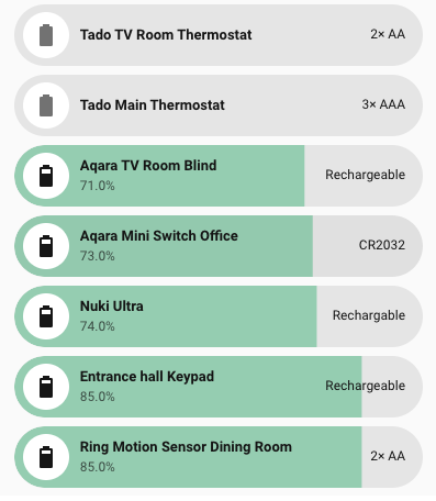

My problem is that I have a lot of Tado thermostats and they don’t provide a percentage value. They don’t have a battery+ attribute. I think the only attribute that can be used to show the battery condition is the battery_plus_low.
But I haven’t manage to get that value yet.

I’m happy with everything else but it won’t help if Tados don’t show the battery condition, which should be Normal or Low.
Hopefully, someone can help me to fix that.

The battery low template won’t help, what you will need to do is create a fake battery percentage based on the devices battery low (not the battery plus low)
You should then get a battery+ percentage, I’d recommend removing the battery note from this device and re-adding it once you have created the helper though.
https://andrew-codechimp.github.io/HA-Battery-Notes/entities/#adding-a-battery-percentage
Thanks @codechimp. I was able to fix the issue by referring to your link.

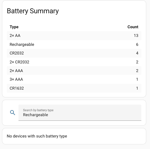

I’ve also implemented the snippet for the battery type search, which works really well. The only problem is that when I search for Rechargeable batteries, it doesn’t return any results.
Do you have any idea why that might be?

Hi, that was a community contributed search, it had a small issue with its search, as it was aimed at just searching for true battery types.
I’ve just updated the docs with a new version here which does work for most cases.
https://andrew-codechimp.github.io/HA-Battery-Notes/community/#search-for-devices-with-a-particular-battery
Hi Andrew, thanks for updating the docs and sharing the new version. I just checked and it works like a charm. Thanks again.

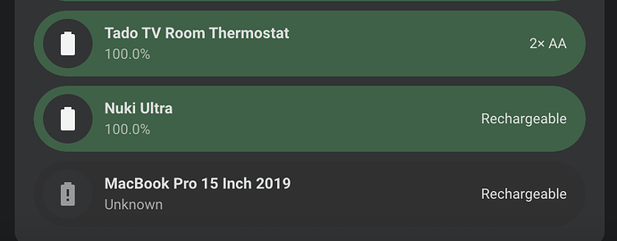

@codechimp I installed the HA app on my MacBook today and, after restarting the HA server, Battery Note successfully recognised it and I was able to add it to the integration.
However, as shown in the screenshot below, the MacBook’s battery percentage is displayed as Unknown.
Do you know what might be causing this? Should I create a template sensor helper for the MacBook?
