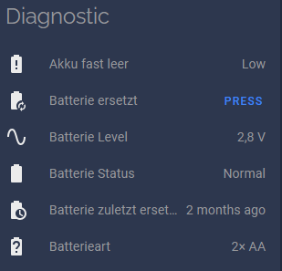

Hey @codechimp.
First, youĀ“ve doing a damn good job with your integration, it make something easier for me. But, i donĀ“t know if i making a mistake or the integration doesnĀ“t work correctly …
I`ve many HM-IP devices, and as you know they don“t show the voltage in percent. Yeah, i know, i can use the low_bat entity but i don“t want that ;o) A while back i“ve found a solution somewhere in the web to calculate the percentage from the voltage.
The MAX bat-level voltage for the HM-IP devices are 3 volt. So i’m using this template to convert the voltage:
{{ ((states(ā€˜sensor.climate_flur_eg_battery_level’)|float(0) - 2.2) / ((3 - 2.2) / 100))|round(0) }}
2.2 volt is the level that is reported in raspberrymatic as a low battery level.
In my example the radiator bat level voltage is 2.8 V. I“m pasting the template in the template editor and it shows me this:
But in your integration it shows me this:
entity_fail_battery_plus_bat_level
Explanation: If iĀ“m using a template it doesnĀ“t show me the ā€œbattery_plusā€ entity. For other devices where i donĀ“t use a template, everything is working correctly
This is by design the Battery Plus will only appear on devices with a ā€œproperā€ battery percentage, not the levels since different devices implement this very differently, from voltages, boolean, strings and also the entity names vary as well making the config very complex.
I haven’t found a solution I like for this yet, so hence there’s no battery plus shown.
Thanks for the fast answer. I understand that, but isn’t a value transferred that Battery Plus can process? The integration receives a valid percentage value. IĀ“m not a coder nor a mathematik genie, but isn’t that basically the same principle? :slight_smile:
For Battery Notes to determine a battery plus it has to look at the available entities and determine if any meet the criteria (it’s device class is battery and unit of measurement is a percentage).
The template you created isn’t part of the device, it’s an associated entity, much like the battery notes entities themselves so Battery Notes won’t find it.
Ahhh all right, now I’ve understood :slight_smile: Then I have to continue using my sensor templates for the HM-IP devices for the percentage.
Thanks for the answer and keep up the good work :slight_smile:
