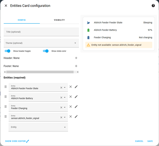

I am having two difficulties implementing this integration.
  1. The sensor entity “signal” does not seem to exist. When I try to add it to an Entity Card, it fails to find it. I found somewhere you said that you “hid” it, but I cannot find how to unhide it.

For signal strength, you unhide it from the Device info screen.
There are 2 ways to get there:
  1. View the integration < Link to Integration – My Home Assistant >, and then click the # device(s) link under your login email (and then click the name of your device, if you have more than one, otherwise it should take you right to Device info if you have just one)
  2. View any other entity from the integration (like the 3 working entities in your screenshot above), and then in the overflow in the top-right, and then Device info.

From the Device info screen, you’ll see all of the active entities, but you’ll also see that some of the sections show “+N entities not shown” - these are the entities that are disabled by default.
Screenshot 2024-12-02 at 7.08.40 PM
Click that to expand it, then click the entity you want to enable. The popup will show This entity is disabled. → now click the gear icon in the top-right, and it’ll again show that it is disabled, and here there’s an “Enable” button, as well as an “Enabled” switch down below - either one works, just enable it and click Update.
Screenshot 2024-12-02 at 6.57.58 PM
It’ll take ~30 seconds for the integration to reload, but once it does, the enabled entities will now appear.
Note that Food level and Temperature are disabled because Bird Buddy’s API still does not provide any values for those. But Signal Strength and Recent Visitor will work once you enable them.

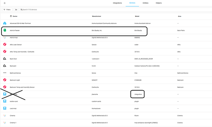

I found out why I couldn’t find the slider to unhide those sensors and I’ll show screenshots for anyone else following along later that may make the same mistake I did. The mistake has nothing to do with this integration, but my unfamiliarity with characteristics of HA UI.
First, I went to HACs and clicked on the Services there to Find Bird Buddy:
I found Bird Buddy in the resultant list:
But then couldn’t find a way to edit the entities in there:
But as madcoder (OP) says above, I need to make sure I’m selecting it a different way.
I need to make sure I’m selecting the Device, not the Integration.
Once I did that, I was able to edit the entity settings under the device.

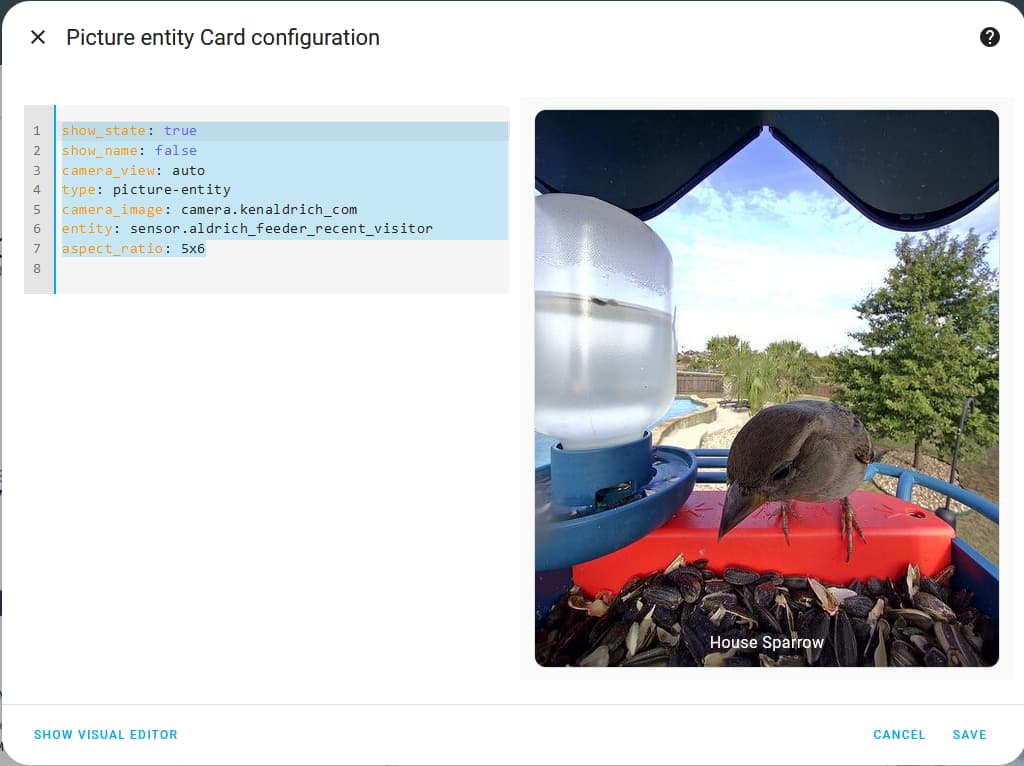

Unfortunately, I still do not know how to correctly use the Generic Camera workaround. I cannot get a valid value entered into the config when I add the integration.

Yeah, right now you won’t be able to add it because your recent visitor entity doesn’t have a picture URL yet (it shows “Unknown” and the bird icon). The Generic Camera Config Flow UI requires confirming the image before it can be saved
But next time you get a bird visit, now that the entity is active, it should set the URL, and you should see the picture instead of the bird icon on the recent visitor entity, along with the species instead of Unknown. Then it should work.
You could also add it in your configuration.yaml file using some of the other examples. If still won’t show the picture until you get your next visitor, but it’ll create the generic camera entity at least.

Now that I’ve had a new visitor after I’ve enabled the recent_visitor entity, the “General Camera” integration should be able to successfully find a photo of the recent visitor so I can “confirm” it before hitting submit on the initial config.
However, I’m still getting an error.
Ok, I got it to work. Again, I think it comes down to specific syntax on the single quote type being copied in this thread vs in the Git Repo thread.
{{ state_attr(‘sensor.aldrich_feeder_recent_visitor’, ‘entity_picture’) }}
The Generic Camera integration is now finding the image:
As noted, now I can add something to one of my dashboards that uses the Generic Camera image.
In this case, I’ve just added a “Picture entity” card to my dashboard and configured it to use the image. Make sure to use the dropdowns to make sure it selects the correct entities and names.
I didn’t write the below example, it is copied from a post by the developer [jhansche]
on one of the git repo posts:
show_state: true
show_name: false
camera_view: auto
type: picture-entity
camera_image: camera.ald_com
entity: sensor.aldrich_feeder_recent_visitor
aspect_ratio: 5x6
Thanks for the clear description.
I had to use double quotes to make it work.
It wouldn’t work with single quotes.
Now that the Image platforms supports loading images by URL, I’m testing a new image entity, which removes the need for the Generic Camera workaround, and will now be built-in. It’s working, but I’d like to clean it up a bit because now the image entity is duplicating the work that the recent visitor entity is also doing. So I’d like to consolidate that so it can be shared between them. Next release should include the new image entity.
