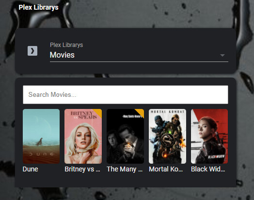

is there a possibility to make the libraryName also an input_select? that way its maybe possible to have 1 card, but to browse to multiple librarys? or how do you guys do it when you have multiple librarys?

Multiple cards each for its own library is the only way right now. You can achieve what you want already by hiding cards in lovelace depending on input select value, so that you will always display just the right PlexMeetsHomeAssistant card.

i am using indeed state-switch conditional cards for the libraries
