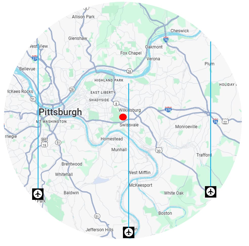

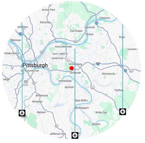

In order to know what direction to look for the plane, the plane’s heading is not important. The integration would need to know the OP’s latitude and longitude and the plane’s latitude and longitude and do math on those values.
EDIT: To illustrate because it’s hard to describe with words, the red dot represents the OP and the three planes are all flying due north and have just entered his observation area. Just knowing the planes’ heading will not tell the OP which direction to look to see the plane.
yeah I hear you…that makes perfect sense…
I’m just basing it off my own setup as I do something similar for observing flights over my house… I have the integration monitoring on a narrow enough area overhead my location so the flight heading tells me exactly where to look…
you are right that the pic paints a thousand words…of course what I’m suggesting doesn’t work over a huge area like you have illustrated, though I’d thought the OP wanted to capture a flight flying directly over a fixed location which is why I was suggesting the approach I did…
thanks for coming back anyway :+1:
