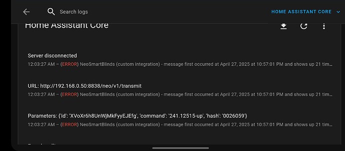

@keyman I know this is an old thread,but did you ever figure out the issue? starting last week when I keep getting connection reset by peer, then need to restart the hub but it is only good for 10 min then same!
The app (neo smart) on my phone works without any issue. Thx

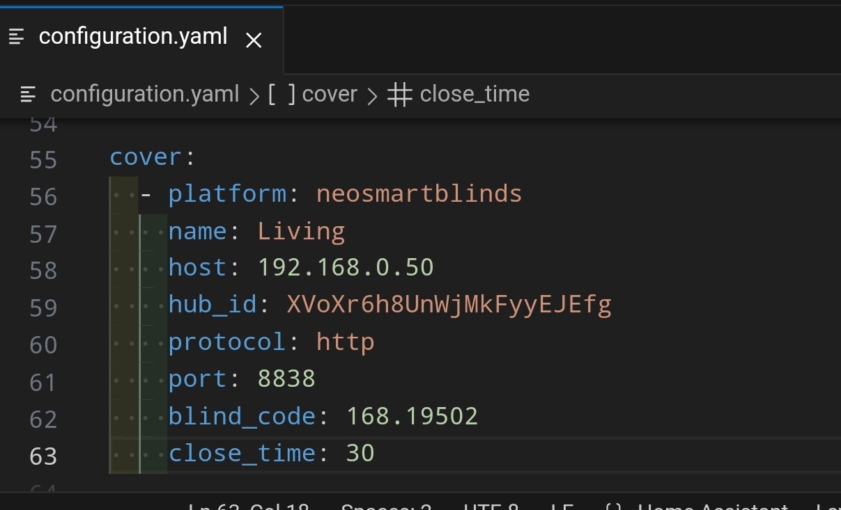

Can someone help me? I installed integration using HACS and add the yaml language below to the configuration file.
However i get the following error
Check your blind code is correct. The format of one of mine is
blind_code: 198.157-00
I have 16 blinds and all have the same format, 111.222-33
The remainder of your code matches mine.
Thank you. That was one of the issues. I misread where it said that a hyphen at the END is no longer needed as meaning that a hyphen is no longer needed. While that fixed the communication between home assistant and my Neo Smart Controller. I could not get it to finally work until i added the motor code.
I have no motor code in my syntax and all works ok for me. Not sure why you would need this as the blind should be identified by the bind code solely through the hub. Nevertheless pleased that you have it now running ok.
