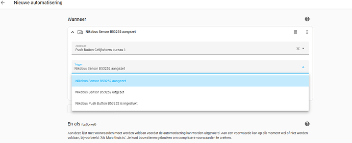

Now I wanted to add an automation when a Nikobus-button is pressed 3 seconds.
How exactly can I configure this.
I can only select if the button is ON, OFF or pressed.
I think I found it. I will test this.

alias: Alles uit aan inkom
description: Alles uit aan inkom
trigger:
  - platform: event
    event_type: nikobus_button_pressed_3
    event_data:
      address: DE4AD2
action:
  - service: input_boolean.turn_on
    metadata: {}
    data: {}
      entity_id: input_boolean.sfeer
You can check that the event is fired with the right address by listening to events ā€œnikobus_button_pressed_3ā€ in the developer tools.
