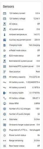

Nice, I managed to install it and it has populated values in HA.
I’ve noted the following - hope this helps.
At the moment it only seems to do a single update of values on first startup of the ESP32. Turning the car on and off, restarting HA or unplugging the obd adapter doesn’t result in an new data coming through to HA.
I can see via the ESP32 log that the OBD adapter and HA are talking regularly (backed up by lights on the OBD adapter).
I’ve attached screenshots of the sensors for reference. So far I’ve noticed:
  • SOC reading 1,310.7206%
  • Odometer is zero
  • There may be other sensors not working but it’s hard to tell due to the sensors not updating.
Note: I’m using it with a 2014 24kWh so some things may be different. Notably there isn’t any clicking in the engine bay.
Thanks for sharing your work. Hopefully this helps.

Awesome! Miracle it works at all tbh.
How are you with accessing HA logs?
Try adding this to your configuration.yaml:
logger:
  default: warning
  logs:
    custom_components.nissan_leaf_obd_ble: debug
Then run it for a while and fetch the logs.
You should be able to inspect the raw data replied from each command.
Compare and contrast with this:
https://mynissanleaf.com/threads/my-nissan-leaf-2021-obd2-elm327-bluetooth-adventure.35042/post-639593

Actually i’m wrong, it alternates in HA between unknown and showing the actual value. The log shows a good connection (excluding the battery controller) every three min (I’ve changed the car off polling to 1min) between the good connections are two unsuccessful connections. This is all on v0.2.0
True values only last about 13 seconds in HA before returning to unknown.
Really need to see the full log to understand what’s happening. Can you message it to me?
My thinking is:
When data is not received from the car, then the sensors should be Unknown: because, they are definitely unknown. This is a bit of a pain for the UI, since you have to dive in to the recorder to see what the value last was when it was connected.
It’s easy to cache the data in the component; it’s just that it’s kind of telling lies.
That makes sense, the last known value can be created by an end user with an automation if it is needed. I’ll message the log to you. Thanks.
Small update:
@daniel.hill.nz there’s a caching option in there now:
This means that it will hold on to the last known values forever. If it errors out for some reason, then the data becomes “unavailable”. The result looks something like this:
Hardly perfect.
