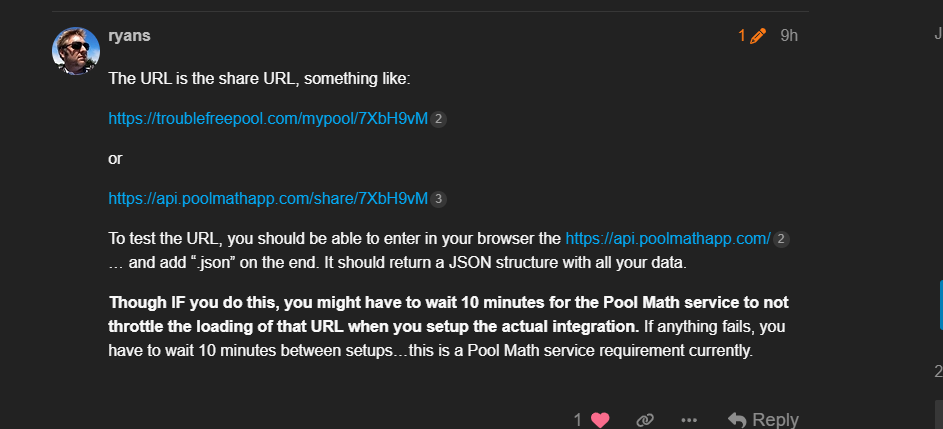

Well that timing is pretty crazy… When configuring the HA integration, do you need to use the “api.poolmathapp…” or the “troublefreepool.com/mypool” web address? I seem to be getting no readings for either

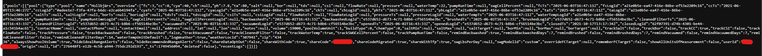

To test the URL, you should be able to enter in your browser the https://api.poolmathapp.com/… and add “.json” on the end. It should return a JSON structure with all your data.
Though IF you do this, you might have to wait 10 minutes for the Pool Math service to not throttle the loading of that URL when you setup the actual integration. If anything fails, you have to wait 10 minutes between setups…this is a Pool Math service requirement currently.

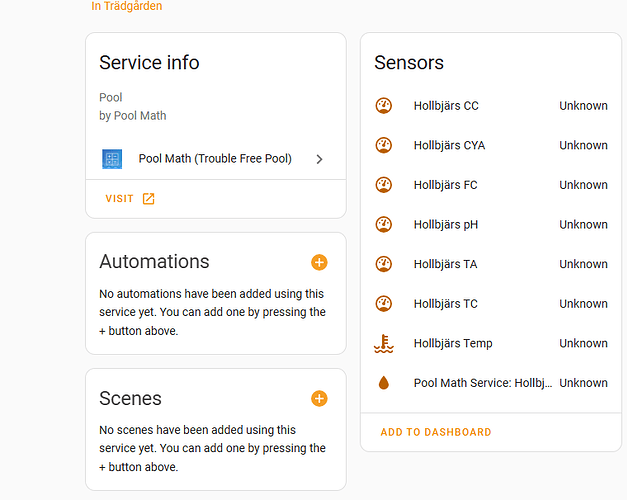

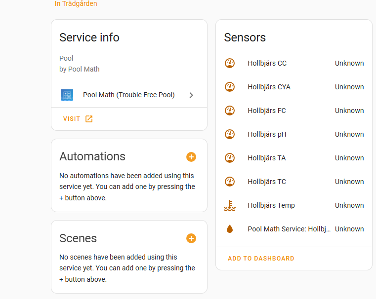

I am having the same issue with ‘Unknown’ sensor(s).
When I plop in my URL (which works, I can confirm by going to the URL), it seems as if Poolmath is saving and using some other URL instead, as if it’s just ignoring the URL I put in when configuring.
