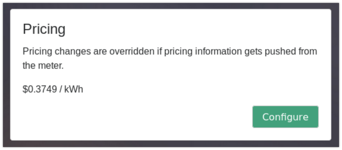

Any chance of pulling in the $/KWH sensor value into the component?

I’ll see that it can be added to the API than to the HA sensor

I setup the gateway to POST to my NodeRED but it didn’t have the price in it. But your post made me go back and check and now it’s showing the value! I’d like to do some automation based on price tiers to reduce consumption so this is great.
Now I need to figure out how to store these into Grafana/Influx.
