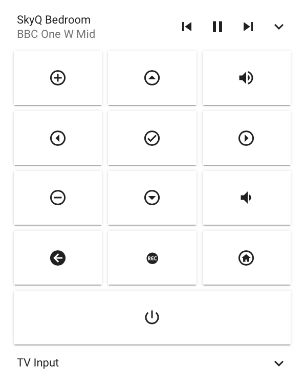

Attached screenshots of my setup. Using mini media player to make a remote, which does all the buttons I need, even volume!
I have TV that is no smart: I have broadlink IR, but I want to try to remove it
@jackm Those UI’s are looking great, please do share the config also either here or feel free to raise a Pull Request with example config in GitHub as part of the readme
