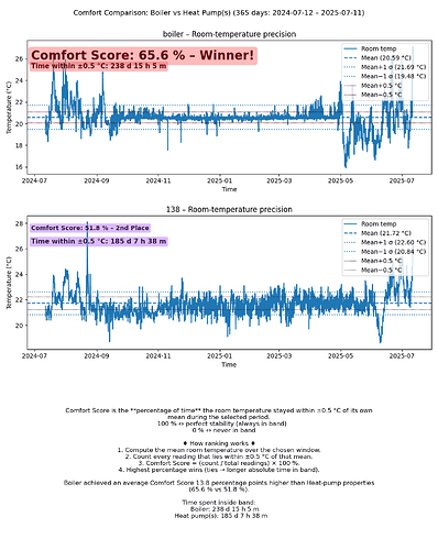

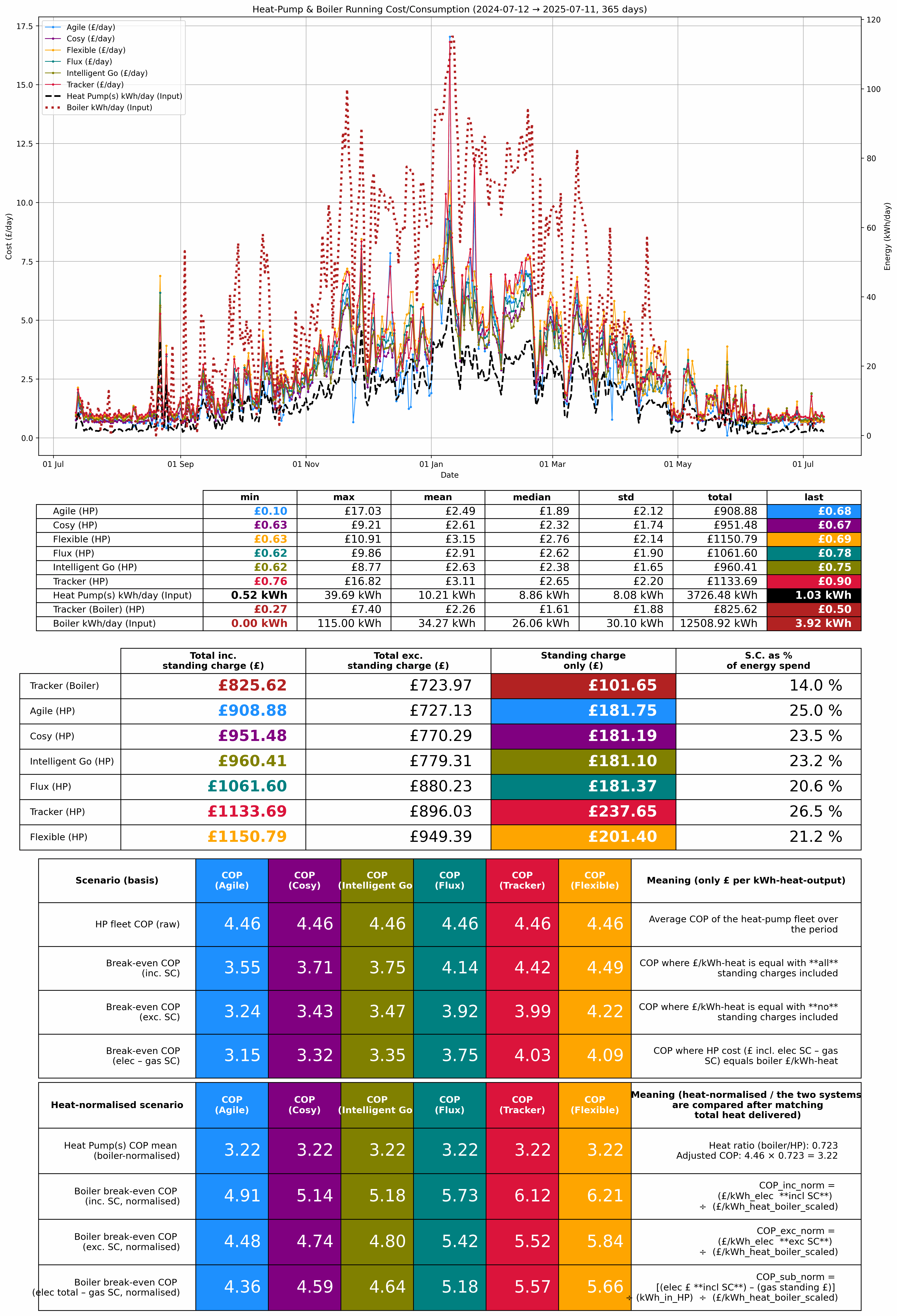

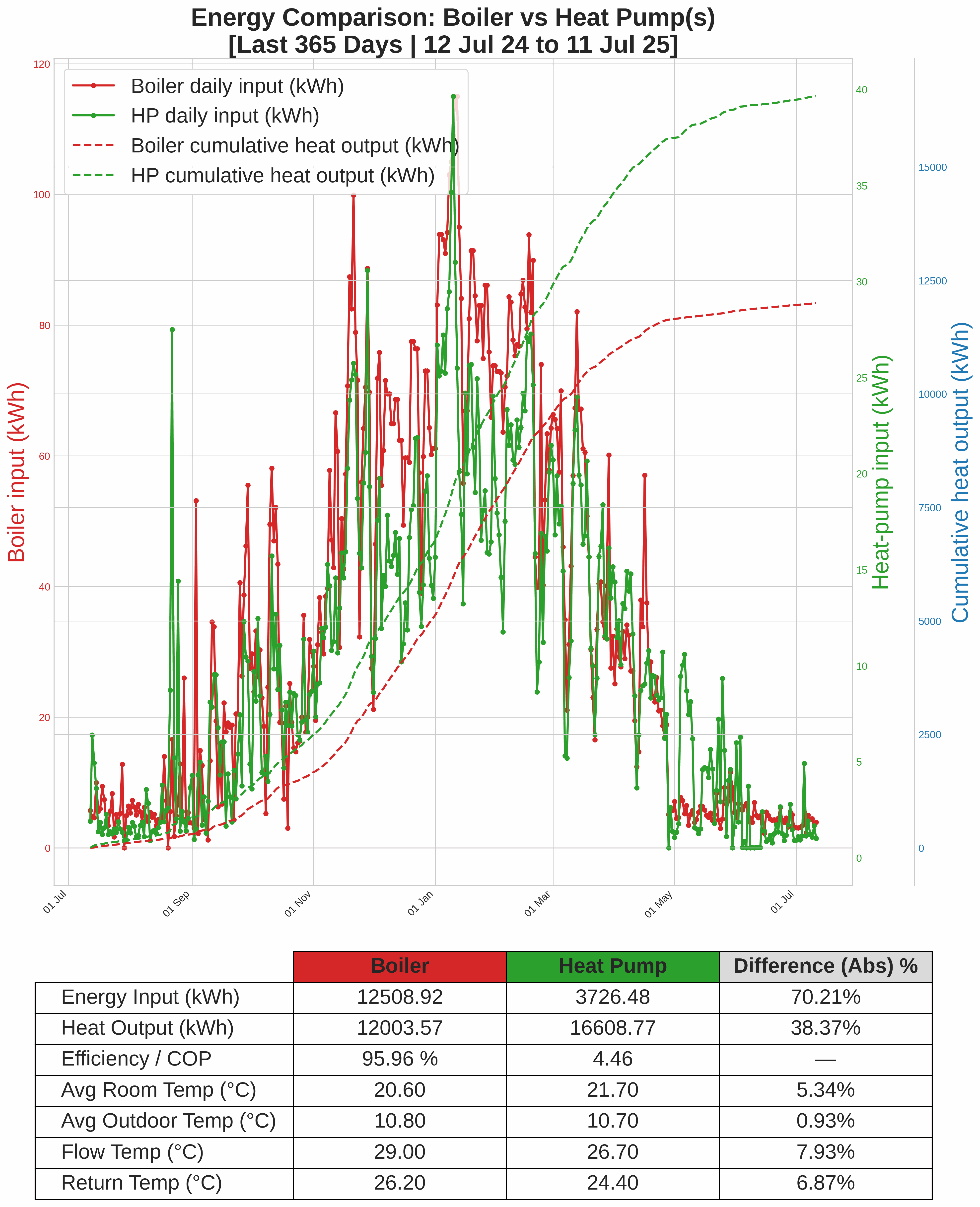

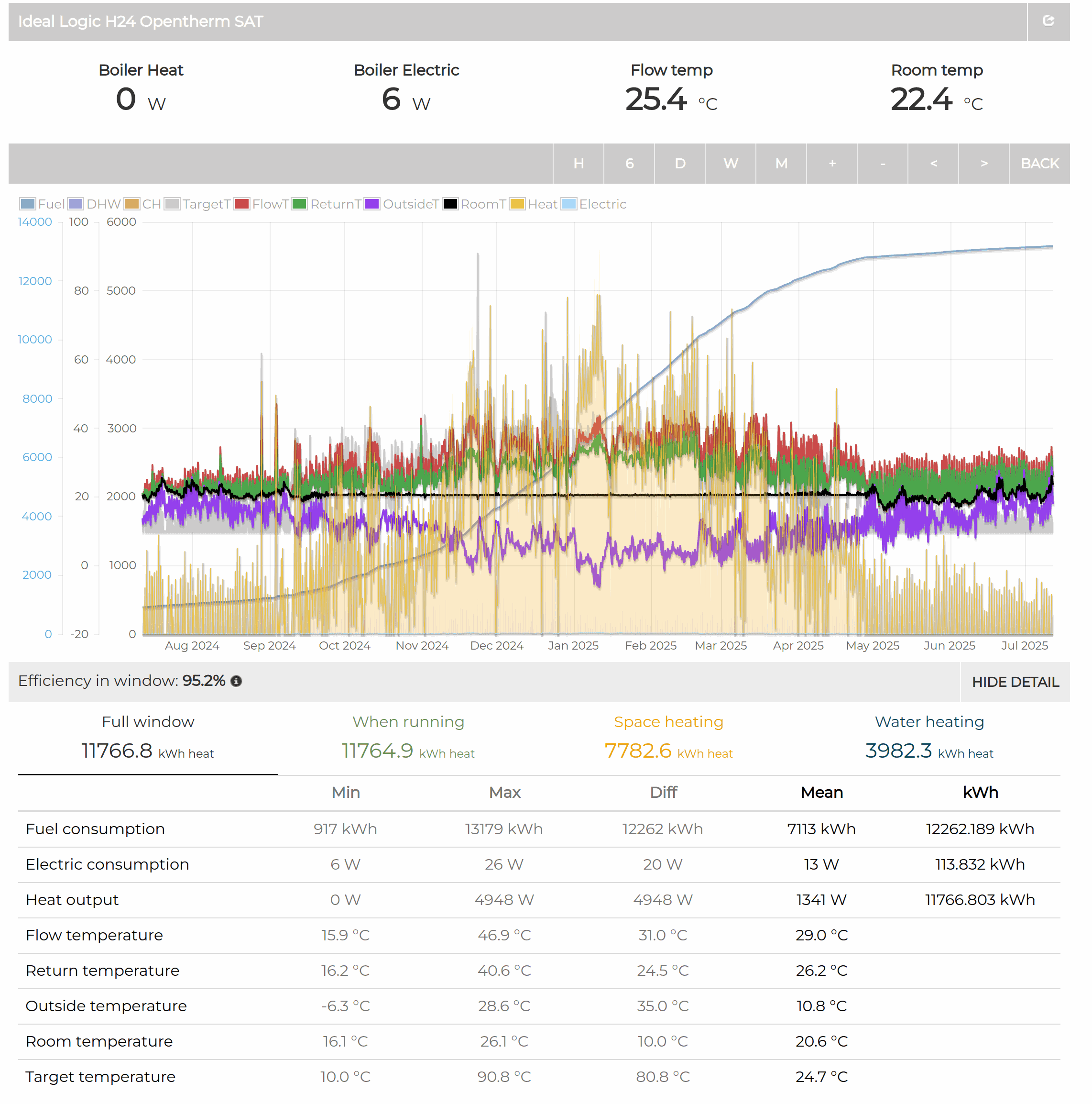

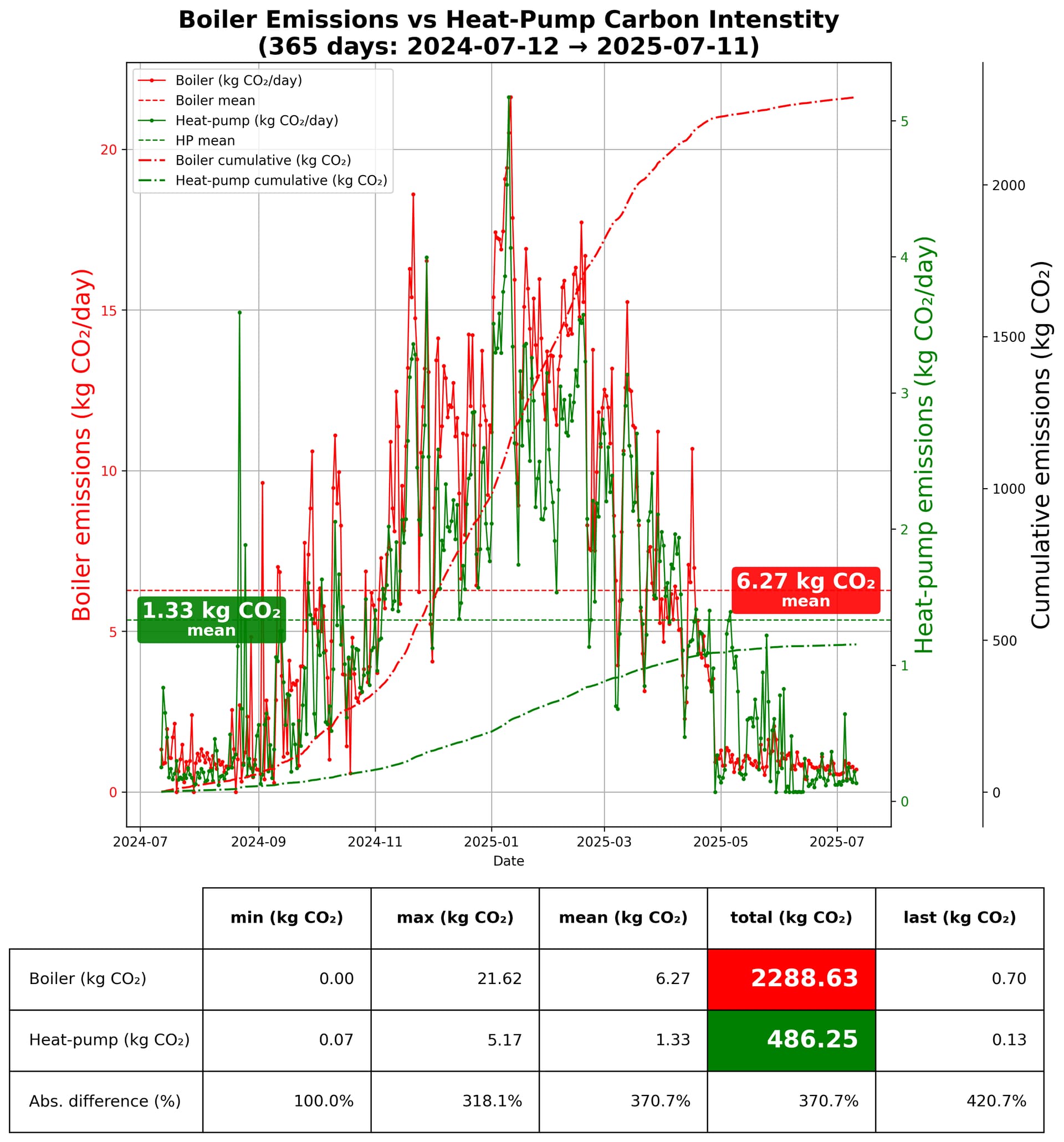

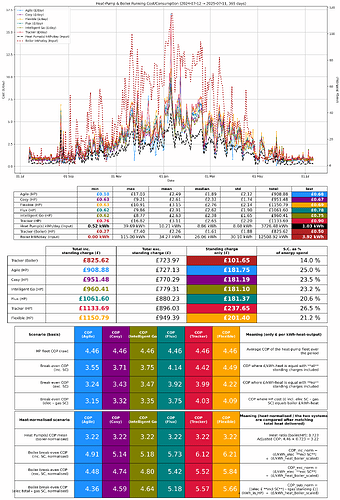

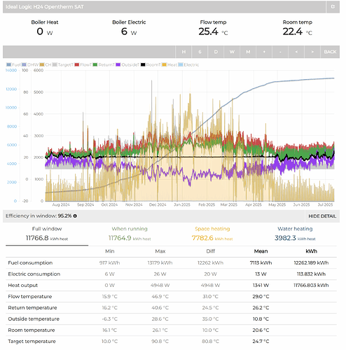

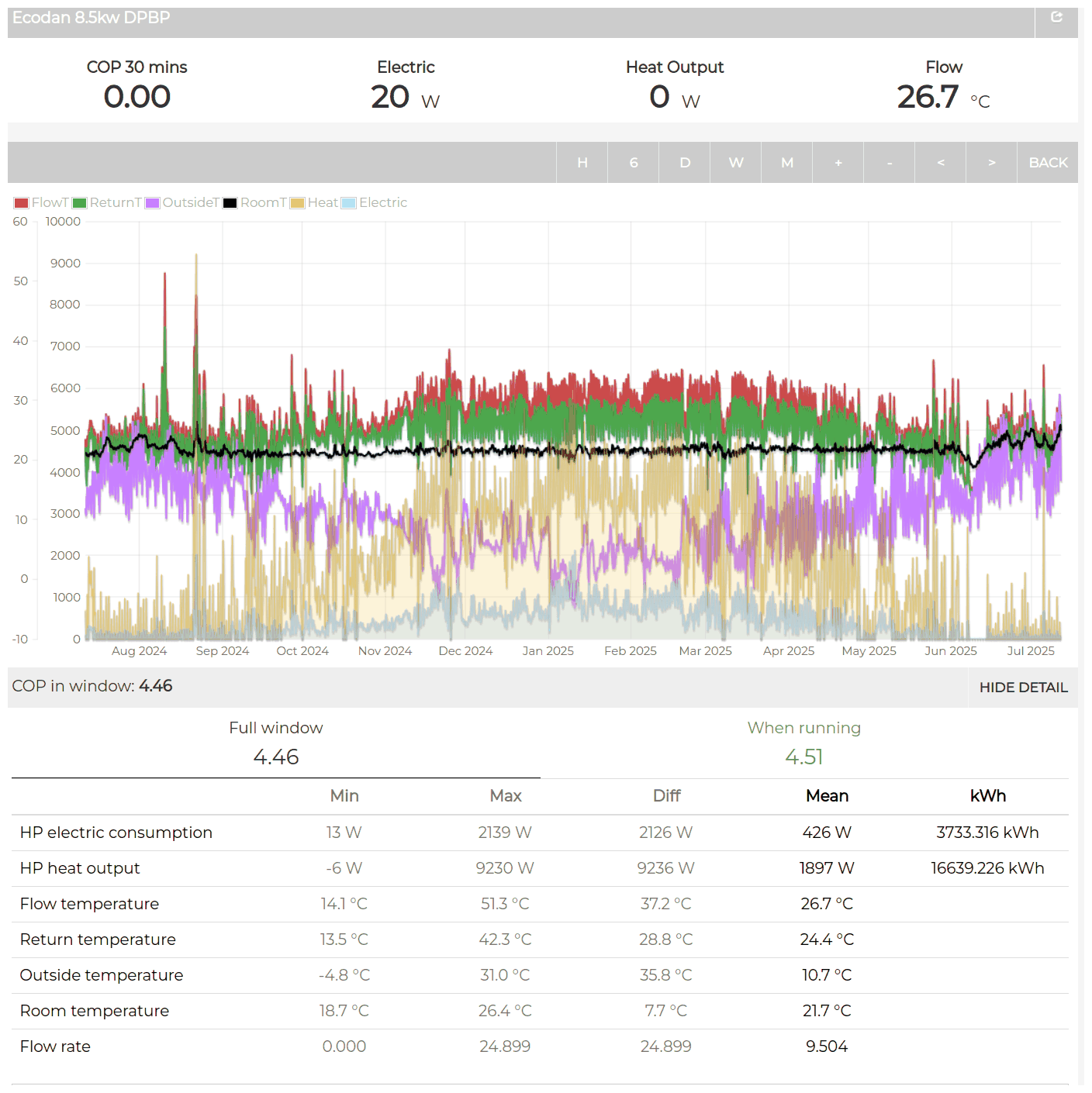

Hi all, a long time SAT user here again. I’d like to share some graphs which compare annual stats between a heat pump and the boiler. Data for the heat pump comes from https://heatpumpmonitor.org/ Both systems are in a similar environment, in terms of house floor area, heat loss and ambient temperatures. Some of these graphs might be difficult to read so please feel free to ask questions.

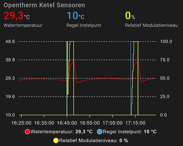

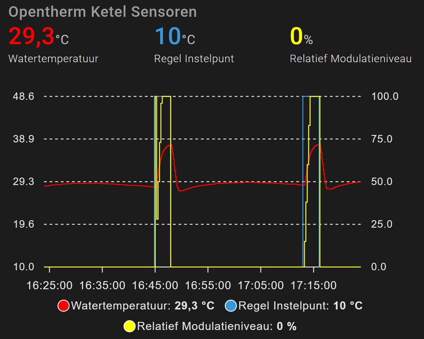

Hi Guys,
I did manage to get de SAT installed finally :). It seems to work correctly, but not in the way that I want. Its controlling the temperature via an on/off way and not modulating as I was hoping for.
Whats happening: the SAT is controlling the temp by setting the setpoint of water temp to 48 degC. After a few minutes (+/- 4), when the water temp reaches the 40 deg degrees (my max T), its turning the setpoint back to 10 degC. That sequense is repeated until the room temp is reached (see pic). reletive modulation is moost of the time 100% So its working but not yet in the most efficient way I gues.
Do you have any sugestions ?
I’m working with an OWGW and selected the option OpenTherm Gateway ( SERIEEL ) during insallation
Hi and welcome! Normally your boiler should work on low load control mode. What’s your boiler brand? There are a few boilers out there that do not accept the maximum modulation management.

:rofl::rofl::rofl:. The usual suspect… Intergas is one of the boiler brands that do not accept maximum modulation management. Don’t worry, we have a solution for that. Go to Configure → Advanced settings → Enable Dynamic Minimum Setpoint ( Experimental ). Then go to General Settings → Minimum setpoint Controller version and check the Boiler temperature option. If it isn’t working properly please feel free to contact again. Thanks!
