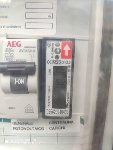

What kind of external meter do you have?
@Cinamon
here you go… I can’t see any brand name on it…
https://shop.marcomweb.it/en/shop-online/fieldbus/modbus-tcp-rtu/pro1-moddirect-monophase-rs485409-979-dettagli.html
