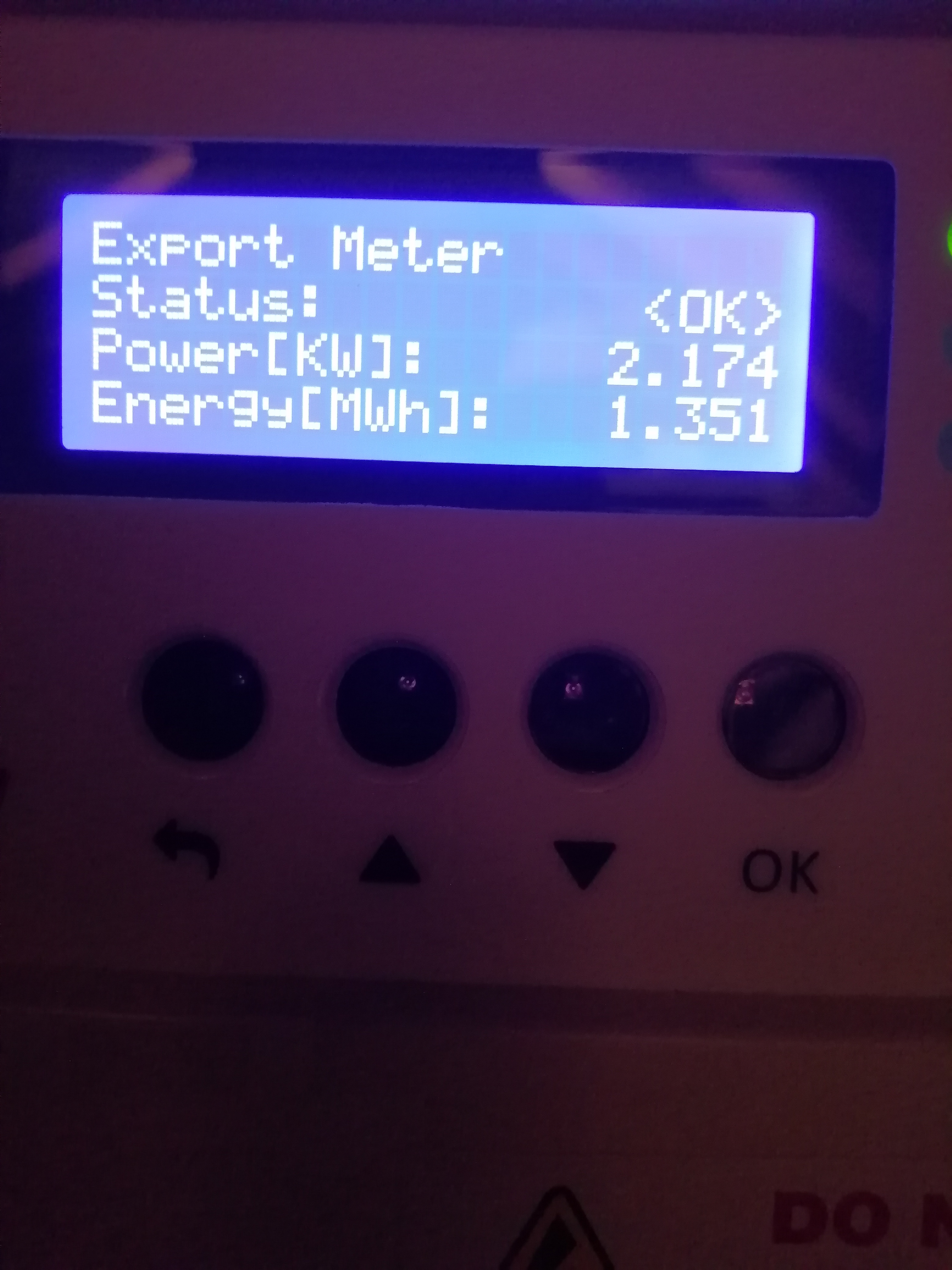

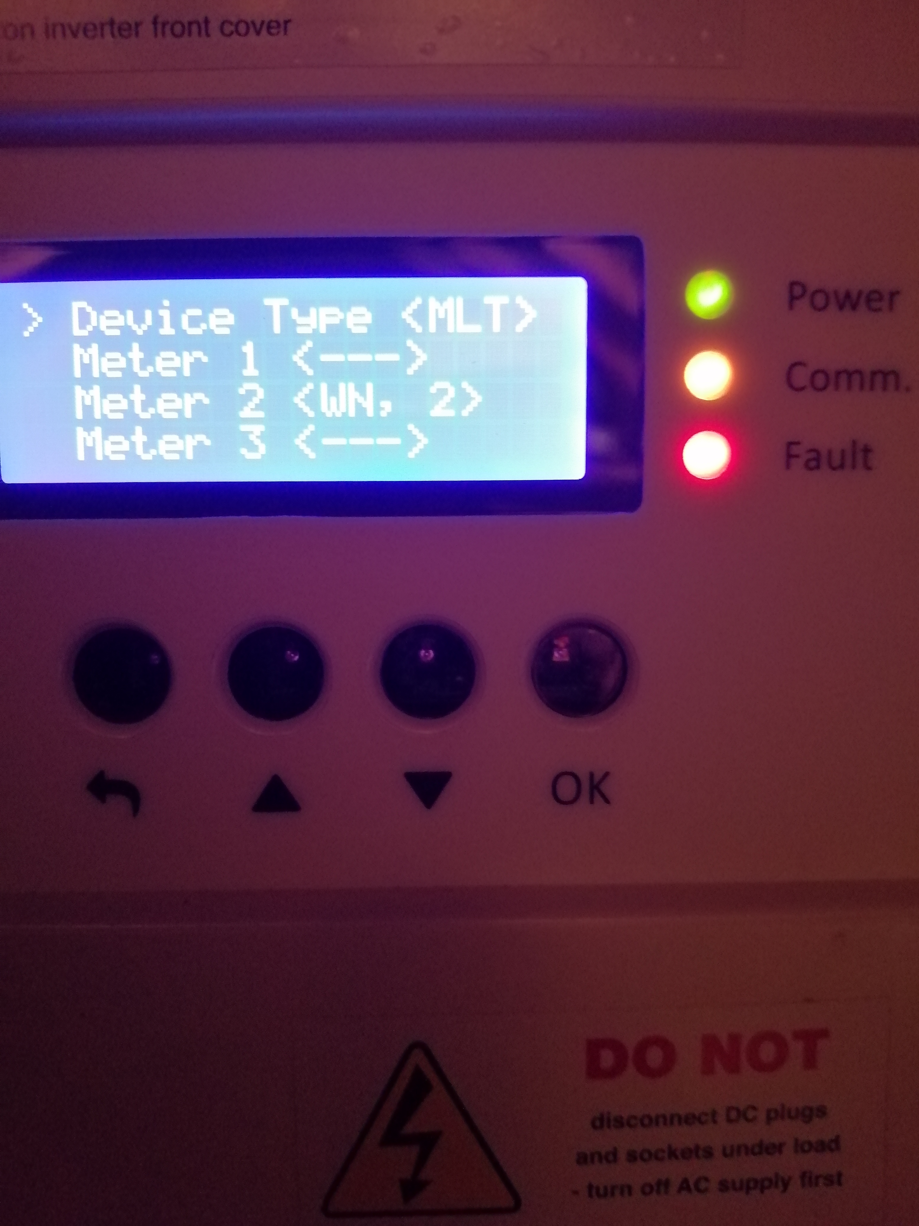

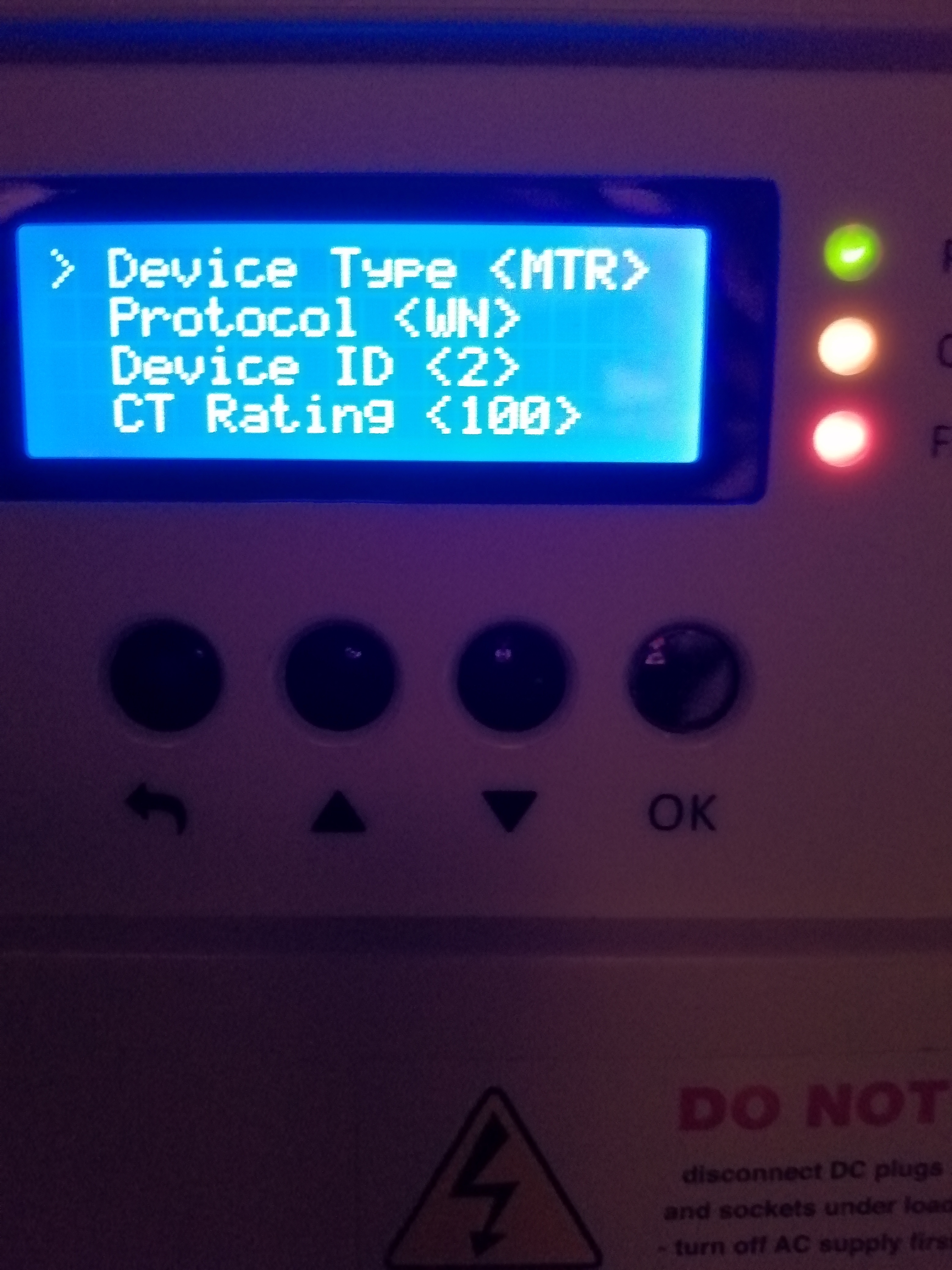

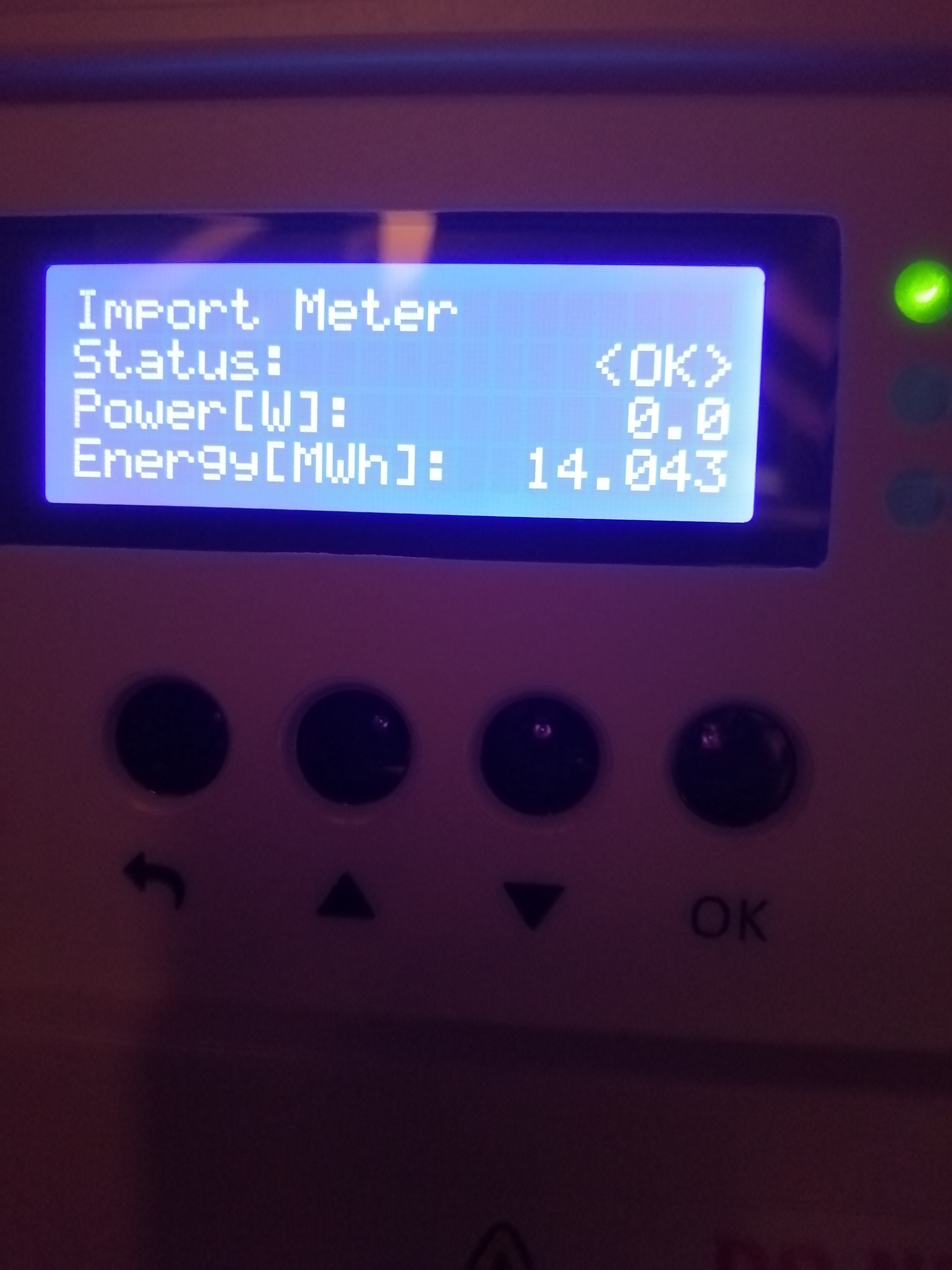

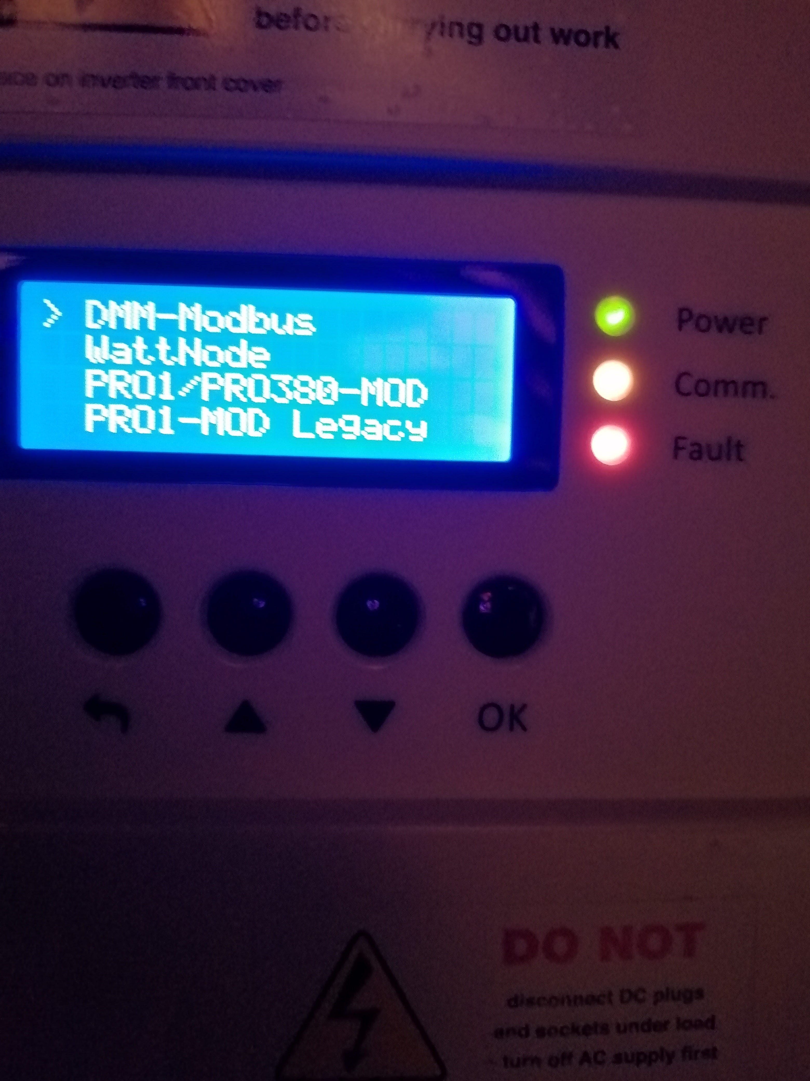

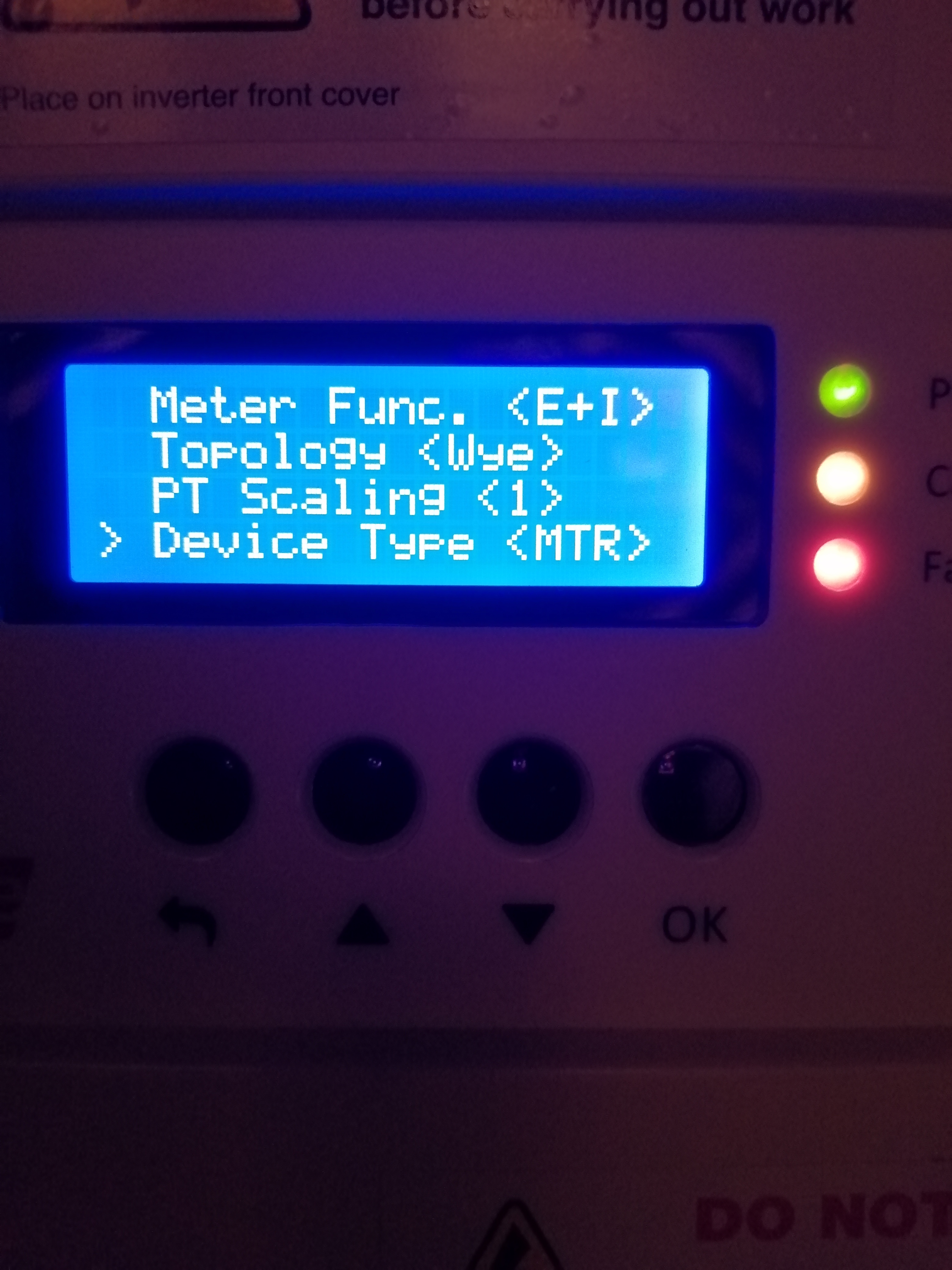

I ventured in to loft and tried the suggestions but still nothing… I have modbus data coming into HA just not the Import\Export data. I’ve attached a screenshot of my inverters display in the hope someone may spot something.
