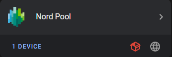

My guess is you are still using the custom integration (can be recognized by the red box on the integration page, attached Nordpool as an example) - which has been deprecated a while ago. Remove the integration, uninstall tedee from HACS and then add it again from the core integrations.
Hi Josef, having done to your advice, it’s working fine, now again!
Thanks a lot!
