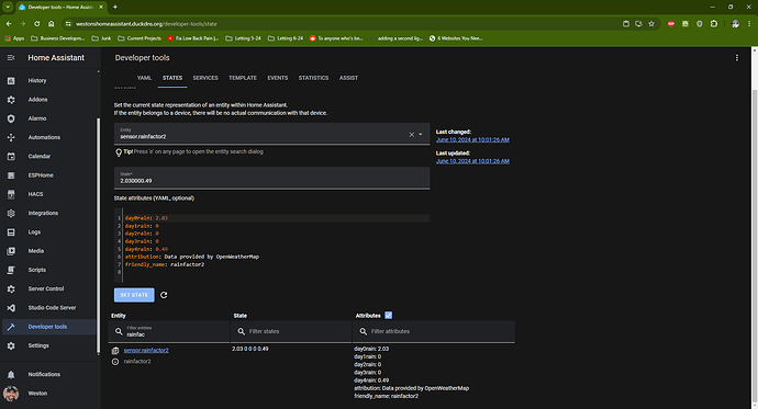

Hello all,
Could someone give me a little guidance as how to fix these errors in my home assistant log that are related to OpenWeatherMap HIstory?
It looks like my sensors are loading values from the integration but I am still seeing these errors in my log. Thank you all so much for your help with this!!

This error originated from a custom integration.
Logger: custom_components.openweathermaphistory.data
Source: custom_components/openweathermaphistory/data.py:62
integration: OWM History (documentation, issues)
First occurred: June 8, 2024 at 10:00:46 PM (1 occurrences)
Last logged: June 8, 2024 at 10:00:46 PM
TimeoutException fetching data: https://api.openweathermap.org/data/3.0/onecall/timemachine?lat=36.22772&lon=-83.31848&dt=1717898400&appid=REDACTED&units=metric failed with
day0rain: 2.03
day1rain: 0
day2rain: 0
day3rain: 0
day4rain: 0.49
attribution: Data provided by OpenWeatherMap
friendly_name: rainfactor2
Hi, this is a result of a timeout when calling the OWM api, it happens occasionally if OWM is not available or there are hiccups on your internet connection.
I thought I handled the error better that that with a more friendly message. I will revisit that in my next iteration. It is difficult to emulate all the various failures that can happen on the net, at least for me.
Cheers
Pete

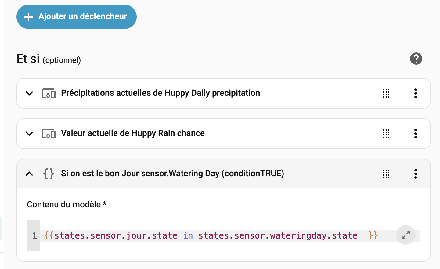

Hi Peter, I am using the OWMH addon and find it very useful. As your Irrigation V5 was not stable in my HA, I use now an automation et adjust the delay as quoted above. My question is : how could I use the “watering days” sensor ( Mon, Thu, Sat" ) in an automation as a condition. Day of the week from HA ? and a chain copmparison ? Help (JF from France where the sun is rather HOT thses days !)

You can use this type of script to determine day of the week and create another sensor.
{%- set current_weekday_num = now().strftime('%a') -%}
{{ current_weekday_num }}
{% if current_weekday_num in ['Mon','Wed','Fri'] -%}
yes
{%- else -%}
no
{%- endif %}

Hi Peter, Thank you for your reply. Yes I use now some similar conditions in this automation, with a helper to keep today’s name and compare with my “watering days” that come from a sensor OWMH from you !
I’ll giv another try to Irrigation-V5 and more feedback to you asap.
