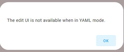

Is it still possible somehow to use the custom element in YAML mode in version 4, or do I have to downgrade to version 3?
You can always edit dashboard components manually in YAML mode, if you switch the edit mode to code mode, or do I misunderstand your question?
My whole UI is in YAML. When I click on “Edit dashboard” I get this message:
In YAML mode I simply get the message, that the custom component doesn’t exists:
That’s the issue I want to solve.

You should still be able to edit this and any custom or built in card in YAML, but I haven’t seen that edit UI not available error before. I was having issues with getting my projects to work on my old dev iPhone and wonder if it’s related to me raising the TypeScript JS target version. I’m going to try lowering it down to ES5 or ES6.
Edit: it didn’t work. I have no idea why 3.3.8 works on old devices but 4.0.0 does not. It’s not due to the configuration UI as the issue also affects my other project Android TV Card.
I don’t know if it helps but I’m seeing the same issue as gerliczky, but only on FireFox… Chrome appears as expected.
Are you guys on older devices or older versions of the browser? Are there any errors in the browser developer tools console? I’m having trouble figuring out how to fix this as I only have an iPhone SE that’s not working, but my older and newer Android and desktop devices are working.

@gerliczky @Didgeridrew can you guys try 4.0.3? I finally figured out what was causing the custom element doesn’t exist error on my old dev iPhone. Hopefully it should fix it for y’all as well.
I tried it and now it works. Also in iPhone 12 in recent Chrome version and also on the recent desktop version of Chrome.
But the solution for me was to use the right URL in my yaml configuration as suggested on the HACS page:
