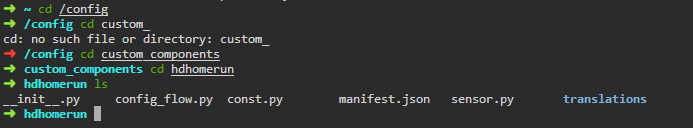

I installed this via HACS, it looks like everything went well but its not showing up in add integrations. Is anyone else having this issue?
The files were placed correctly from what I can see
Figured it out, found it in the logs
2022-06-23 10:13:53 ERROR (SyncWorker_1) [homeassistant.loader] The custom integration 'hdhomerun' does not have a version key in the manifest file and was blocked from loading. See https://developers.home-assistant.io/blog/2021/01/29/custom-integration-changes#versions for more details
That’s not this integration. Did you add the GitHub repository from the first post as a custom repository in HACS?
LOL thats very confusing, HACS has an integration built into the master repo, i thought that was this
They look almost identical LOL
